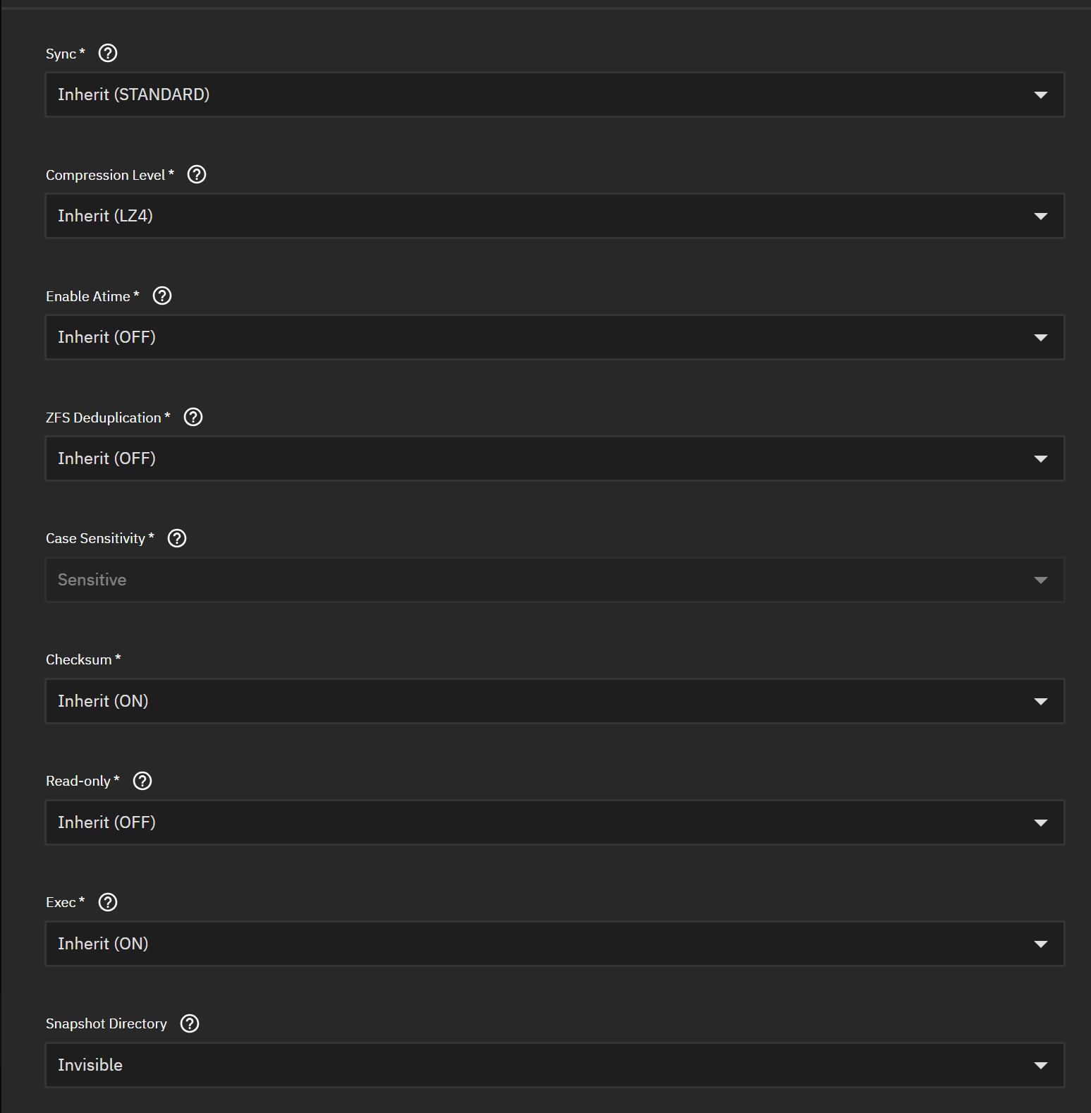

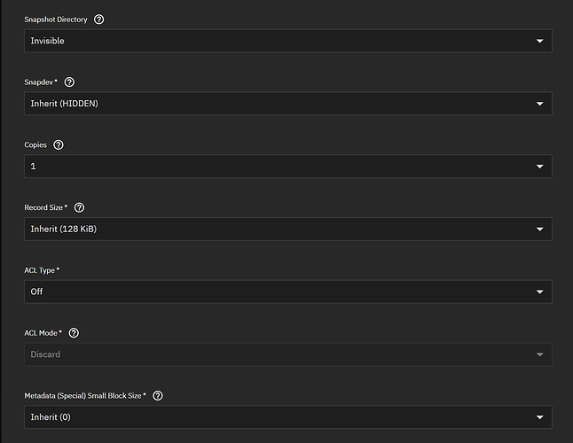

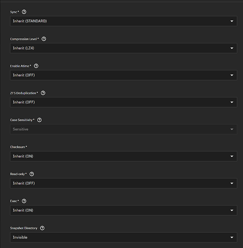

@Captain_Morgan thanks very much for your reply. The pool consists of two zvols of 30 and 15 disks. (I know the zvol config is horrendous but it’s the one we’re stuck with). dataset size is 55TBs. Please see screenshots for dataset options.
please let me know if you’d like me to share further details.

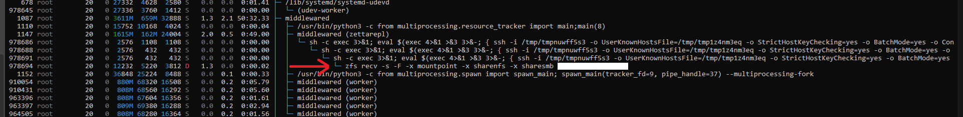

the replication is running as we speak (7TBs out of 55TBs) and I don’t see a zfs recv process on the backup NAS. Is there another way of looking for it?
as for the restart, when I do it, replication restarts from scratch for some reason.
You can use htop to browse processes. There should be a zfs recv process. Somewhere parented under to middlewared (zettarepl) process.
