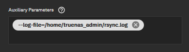

I faced the same issue today. I added logging to rsync, and found out that in my case the issue was caused by permission issues. To add logging to rsync add following configuration to the job:
Depending on your setup/rsync user you may need to set different path.
