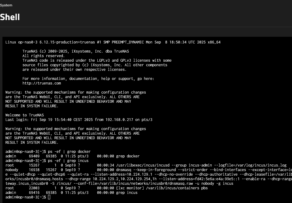

Does Truenas actually use Docker. If yes, pf-ef|grep docker should give me some lines of output. However, it doesn’t.
pf -ef is not a command. I think you meant ps -ef which works fine.
ps -ef | grep docker
root      231569       1  0 Sep16 ?        00:03:27 /usr/bin/dockerd -H fd:// --containerd=/run/containerd/containerd.sock
root      616391  231569  0 06:06 ?        00:00:00 /usr/bin/docker-proxy -proto tcp -host-ip 0.0.0.0 -host-port 31054 -container-ip 172.16.1.2 -container-port 8080
root      616399  231569  0 06:06 ?        00:00:00 /usr/bin/docker-proxy -proto tcp -host-ip 0.0.0.0 -host-port 31055 -container-ip 172.16.1.2 -container-port 8086
root      633414  633314  0 07:22 pts/1    00:00:00 grep docker
I don’t see any Docker here. Only Incus.
Did you configure apps in the web ui? I.e. go to Apps > Configuration > Choose Pool.
like @bacon said, if you did not set a pool for the apps, the docker service is disabled. Only when choosing a pool it will start.
