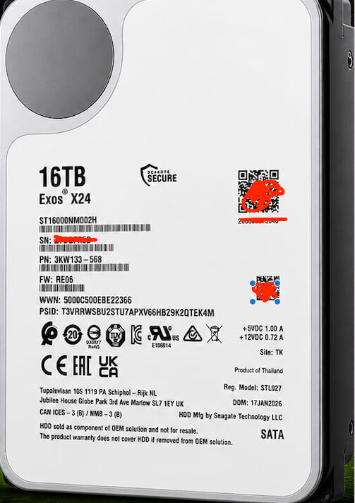

Basically, I wanted to know what is more reliable? X16 or X24. Both, 16TB models. Here’s a picture of the X24 drive.

I’ve attached the picture of the X24 drive in the above post.
