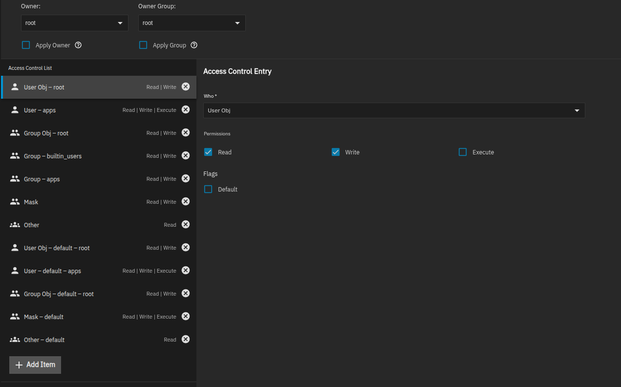

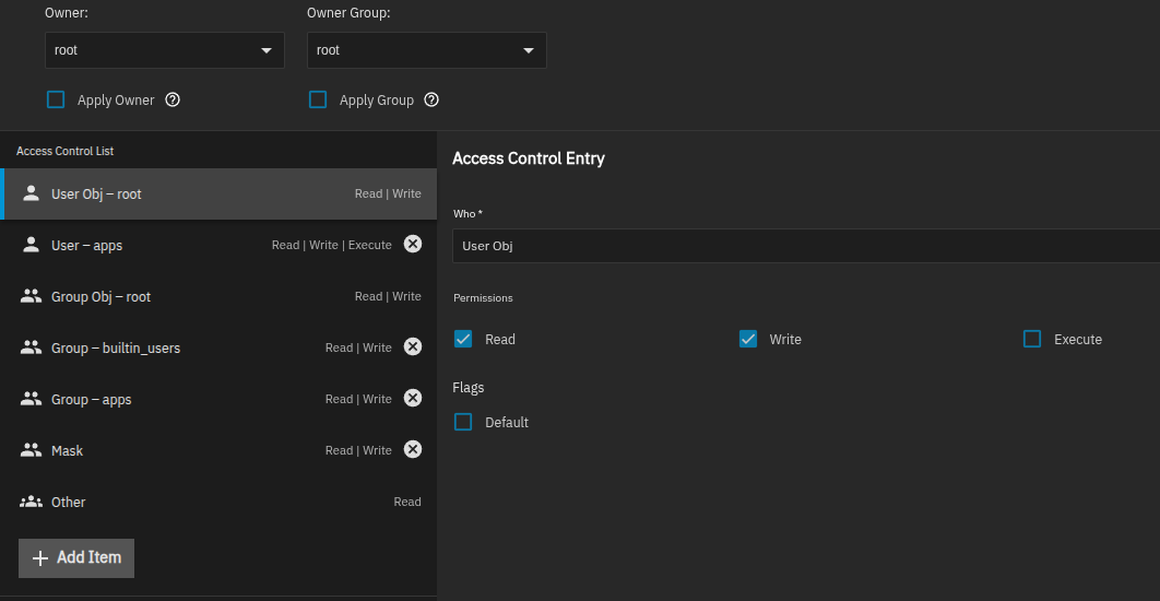

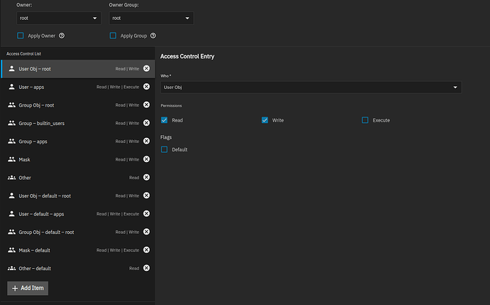

I’ve attached pictures of the current permissions lists I’ve been trying for a test dataset. Owner and Owner Group are left as root. On the second screenshot, I’ve deleted some of the default permissions in case they were causing conflicts. Both setups just lead to Error 403 when I try to upload a file to the dataset using Filebrowser.

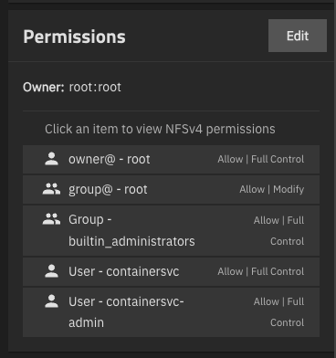

Each app gets its own “app” dataset. Every app’s dataset is ACL’d like this:

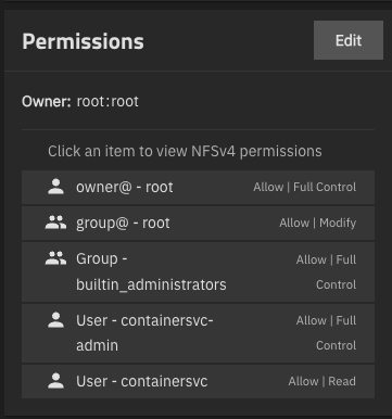

For the “data” datasets, including the datasets that Syncthing syncs, the ACLs are:
To create the “data” datasets, the pattern I’ve found that always works is to create them as “Multiprotocol” and then uncheck the “Create NFS Share” and “Create SMB Share” checkboxes. Then just set the ACLs.

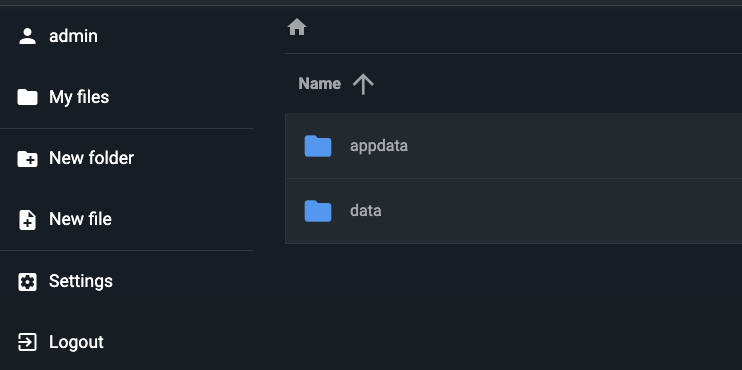

With the ACL model I showed you above, and File Browser running as containersvc-admin (2001), this gives me two root folders in File Browser and everything underneath is writeable.
So in my case, it looks like this at the root, which may be what you want, too:
