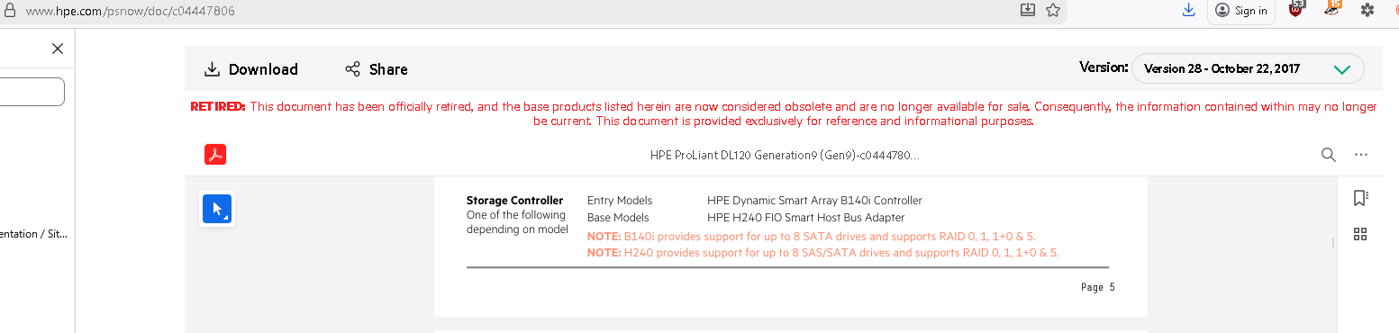

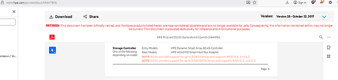

It looks like the Proliant DL 120 Gen9 could have come with two different controllers. If I got the correct docs.
One is mentioned on the ServerTheHomeForum and shows an example of making sure it was in HBA and not RAID.
