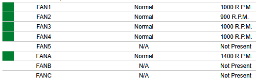

   # Get reported fan speed in RPM from sensor data repository.
   # Takes the pertinent FAN line, then 3 to 5 consecutive digits
   SDR=$($IPMITOOL sdr)
   FAN1=$(echo "$SDR" | grep "FAN1" | grep -Eo '[0-9]{3,5}')
   FAN2=$(echo "$SDR" | grep "FAN2" | grep -Eo '[0-9]{3,5}')
   FAN3=$(echo "$SDR" | grep "FAN3" | grep -Eo '[0-9]{3,5}')
   FAN4=$(echo "$SDR" | grep "FAN4" | grep -Eo '[0-9]{3,5}')
   FANA=$(echo "$SDR" | grep "FANA" | grep -Eo '[0-9]{3,5}')

I’ve “tamed” the fans for now by killing the script after it had set them to 900, 1000 and 1400 rpm so the server doesn’t cosplay as a fog horn (10 3000 rpm fans are quite loud).
And in case it’s relevant, here are the sensor readings for the fans from IPMI:
