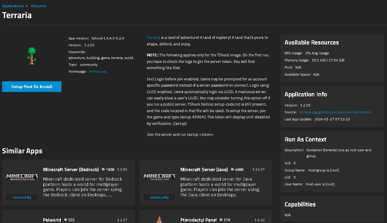

This is what I see off of TrueNAS 25.10.1

You wait for the app maintainer to update it. It was just updated Jan 27th, per the screenshot.
If you need updates faster, you can install it as a custom app and do updates yourself.
