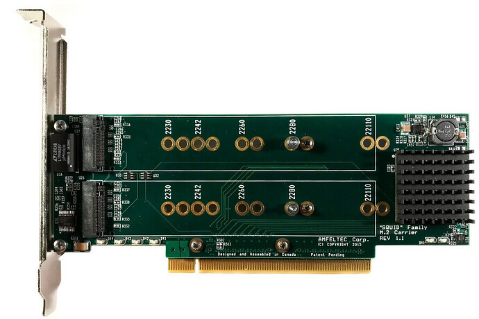

RAIDZ1 - Single VDEV - 5x Intel Optane 905P 960GB
So now I have, what I had before,
AMD EPYC 7F52 16C-32T
REPLACEMENT Supermicro H12-SSL-I
256 GB (8X32G) DDR4 3200MHz RDIMM
In the old forum I had done some testing with differant PHY/BUS layers or Generational Improcements…Like doing bifurcation or using a PLX switch or upgrading from one hardware generation to the next.
I hope to pick this back up in a more meaningful way now, measured with tn-bench. Lots more PCI-E lanes to play with :slight_smile:
