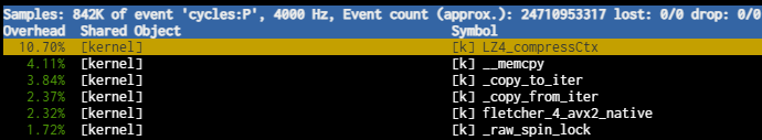

I hope I didn’t miss it, but what’s your exact hardware?
Furthermore: Please post the average output (highest 3) of [sudo] perf top while transmitting files.

As for my hardware:
NAS: i5 12600, 32Gb ram, mobo is ARKTEK B760 DDR4 AK-B760M EG.
PC: Ryzen 5600X, 32Gb ram, Intel gpu, mobo is AB350M-DS3H.
While transferring a ~20gb file.
Now, that looks reasonable. Glad you solved it.
