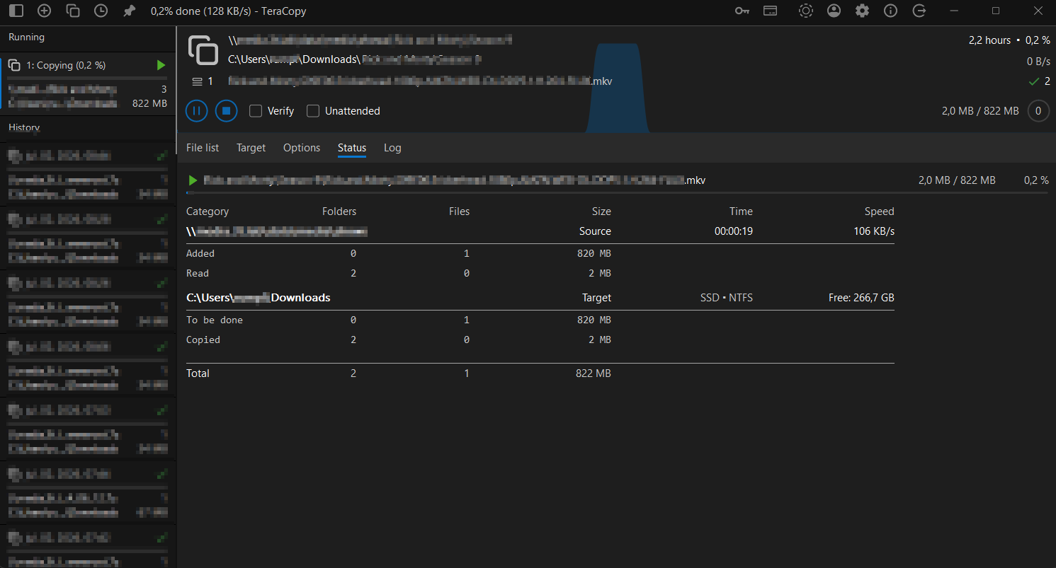

Now when I copy from TrueNAS SMB to another machine in the same network I get max 85MB/s transfer rate on my 1G network. So already there is something fishy going on with the network.
I previously had a LXC running only SMB service and I got full speed there.
I use Unifi sitemagic and there things get complicated.
When I copy from TrueNAS SMB over that (what actually is a WireGuard VPN) network I get transfer pauses on the remote machine (using TeraCopy) :
Jellyfin playback is broken too, behaves the same as the SMB transfer. I get 5 second of playback then a long pause, then 2 seconds of playback then a long pause and so on.

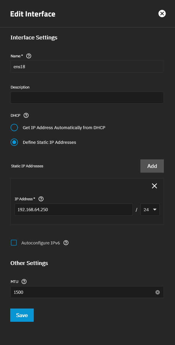

Turns out that this all points to MTU issues.
I tried to change the MTU on the network adapter for the VM and in the TrueNAS to 1380. That didn’t help.
I set it back to 1500:

I would like some help with this.
Found the solution. I hope this helps someone with the same problem.
In Proxmox, for the given VM change the MTU on the network device to 1.
