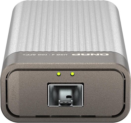

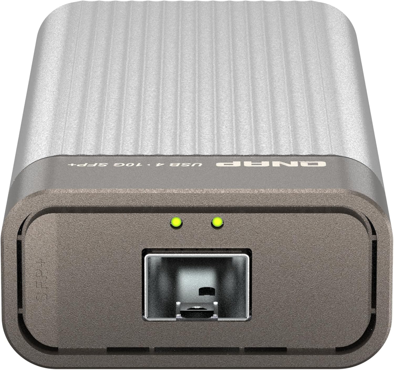

I really like the QNAP Thunderbolt 3 to SFP+ adapter. Bus powered and I can use any SFP+ transceiver in it.
