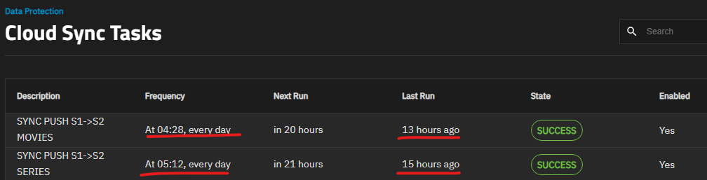

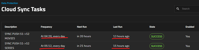

as you can see in this picture, the red lines makes no sense, “Last Run” is the last time i MANUALLY ran the tasks (because i am triggering them manually since it isnt working by its own when times comes)… if the Cloud Sync Tasks would work as it should be then the “Last Run” should say something like 4 and 5 hours ago (im just doing the math between actual time at home and the time i should have been synced)
hope this can clarify a little bit my first post

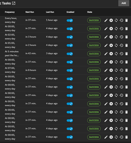

any update on this?
Still not working for me
OS Version:25.04.2.1
at least for me, i doesn’t work yet.
