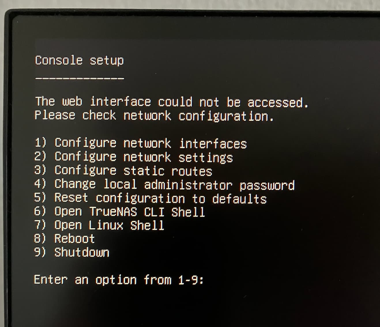

Need some advise. My TrueNAS loosing network after few reboot’s. It was working fine for few days (fresh installation), but after the last reboot it says: “The web interface could not be accessed. Please check network configuration.”. This is strange as the last time it was working fine.

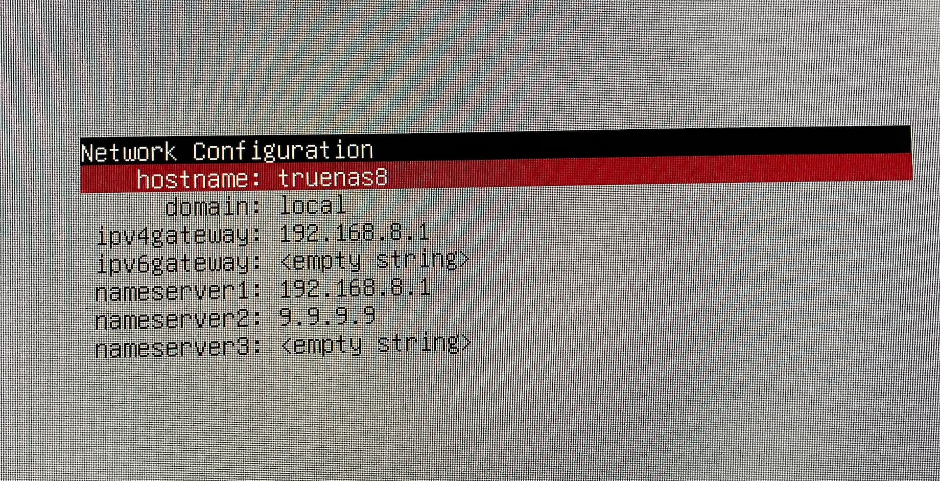

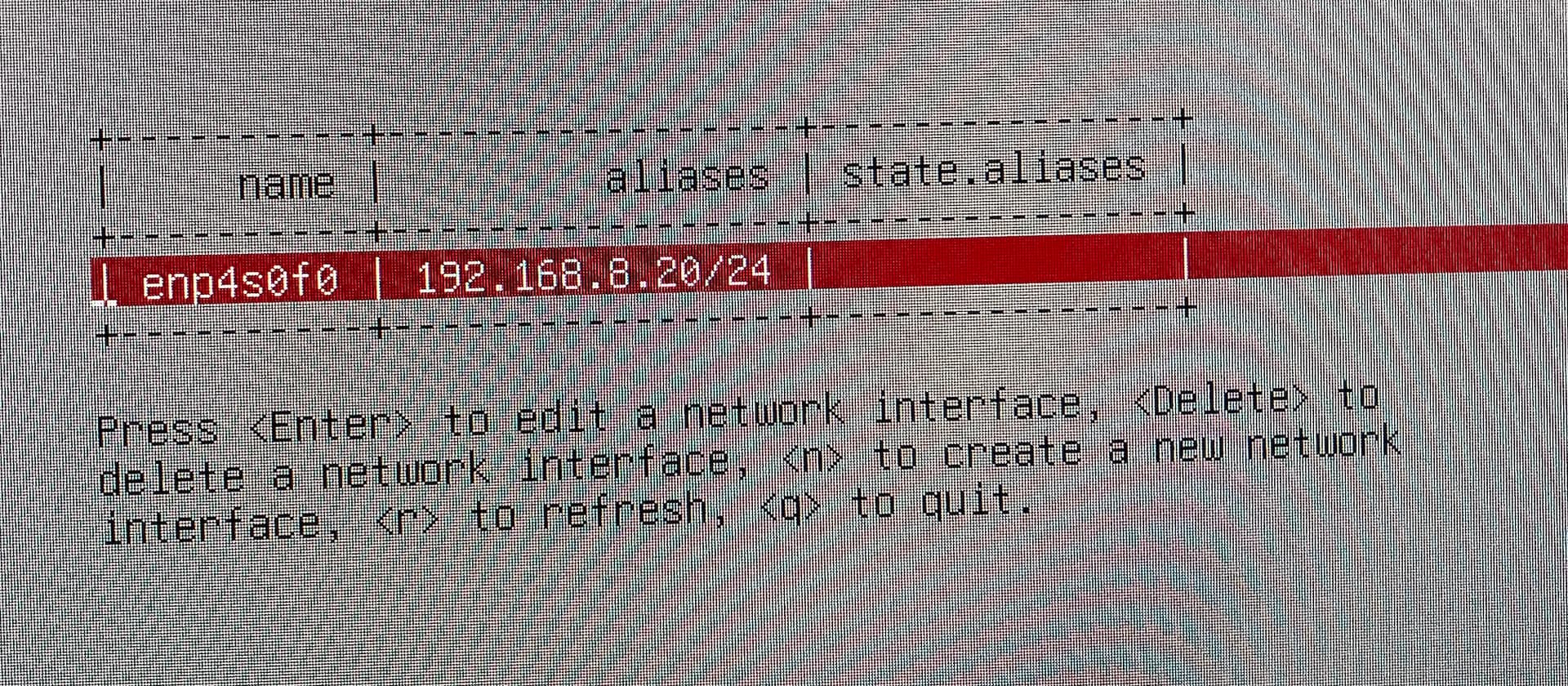

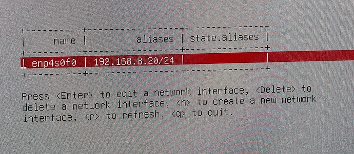

Strange thing is that i see correct configuration, please see attached files. It have correct static IP, GW, NS (please see images).

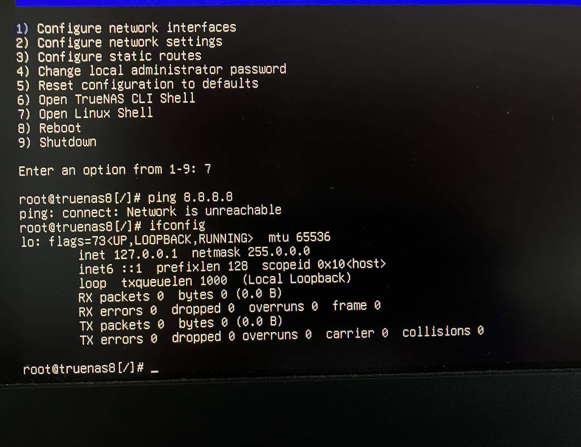

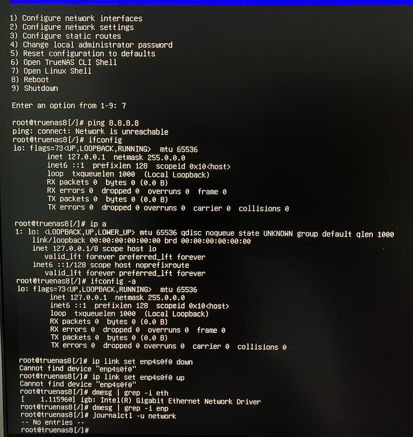

It appears that the Intel NIC is not being detected or initialized properly. The driver for the Intel NIC seems to load (Intel Gigabit Ethernet Network Driver appears in dmesg), but the interface itself (enp4s0f0) is not present in ip a or ifconfig.

Looks like the nic setup in the cli is right…

The Nameserver, you have it set to the same as the gateway, is that correct in your setup? Won’t make a difference for pinging 8.8.8.8 but a question

I can’t ping.
Neither from PC a TrueNAS, neither from TrueNAS to PC.
Nameserver is correct. It was working like that before with no problems.

On your truenas console, click 3 and go into static routes.
Anything there?
static routes are empty, but as i know static route is not necessary because the network configuration (IP address, gateway, and subnet mask) should be sufficient for proper connectivity.
At this point TrueNAS can’t see device “enp4s0f0” (Intel NIC).

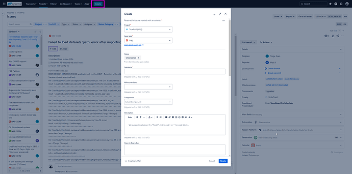

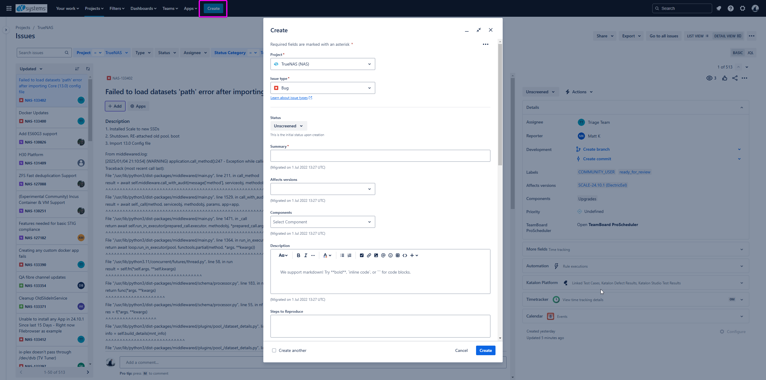

Raise it on their Jira directly, normally you can raise it just through the truenas UI, but obviously if you’re not able to reach the UI, that will be slightly hard
Link: TrueNAS - Issues - iXsystems TrueNAS Jira
Probably need to create a account, but you should be able to create a ticket from that and mark as a bug
Thank you for the link. Registered, created a ticket, waiting for reply.
https://ixsystems.atlassian.net/browse/NAS-133415
