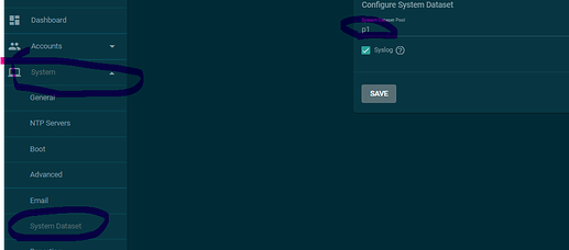

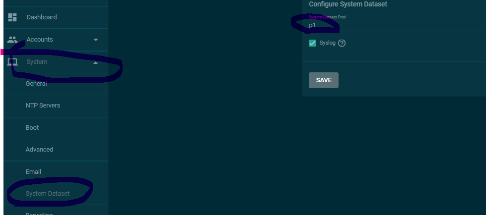

Check where system dataset is located and take it off your source pool if your going to destroy the pool.

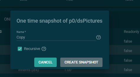

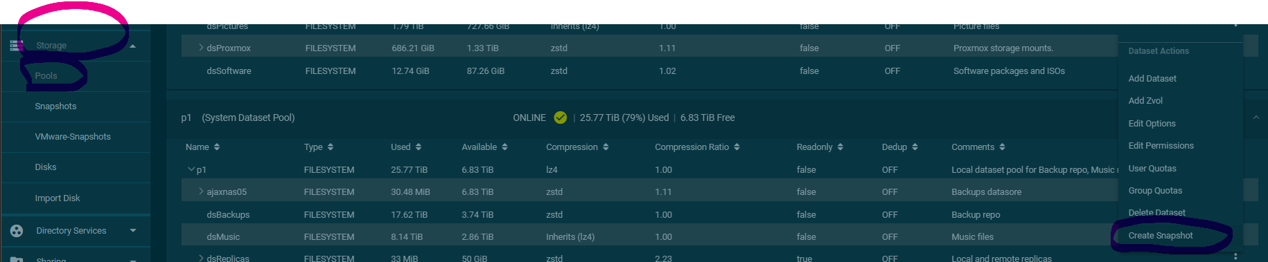

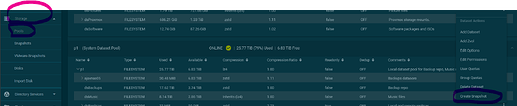

Manually create a snapshot of the existing Source dataset
Name it something useful to you

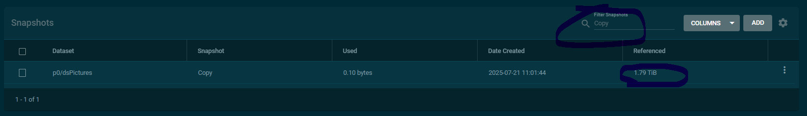

Check it exists in the Storage>Snapshots panel

Delete the snapshots @Copy from the Storage>Snapshots panel.
