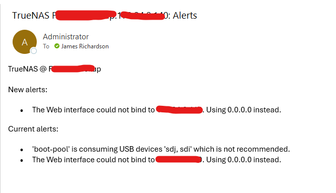

I have just got the following email from the server, so the configuration must be working.
Regards,
James

Hi James,
I have this issue also when upgrading from CORE to SCALE and also using LAGG / LACP bond. I find a reconfiguration of the network interfaces via the console clears things up. Not sure why it happens but it’s an easy enough fix.
