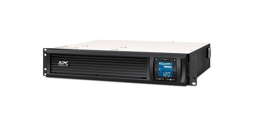

Woot has the APC SMC1500-2UC in new/open box condition, for a limited time (as their deals often are), for $327.59. Free shipping if you’re an Amazon Prime member:
Note that this model doesn’t have a slot for a network interface. It has its own onboard, but it appears that it’s intended for cloud-based monitoring; no idea whether or to what extent it does or can be made to work for local network monitoring.
