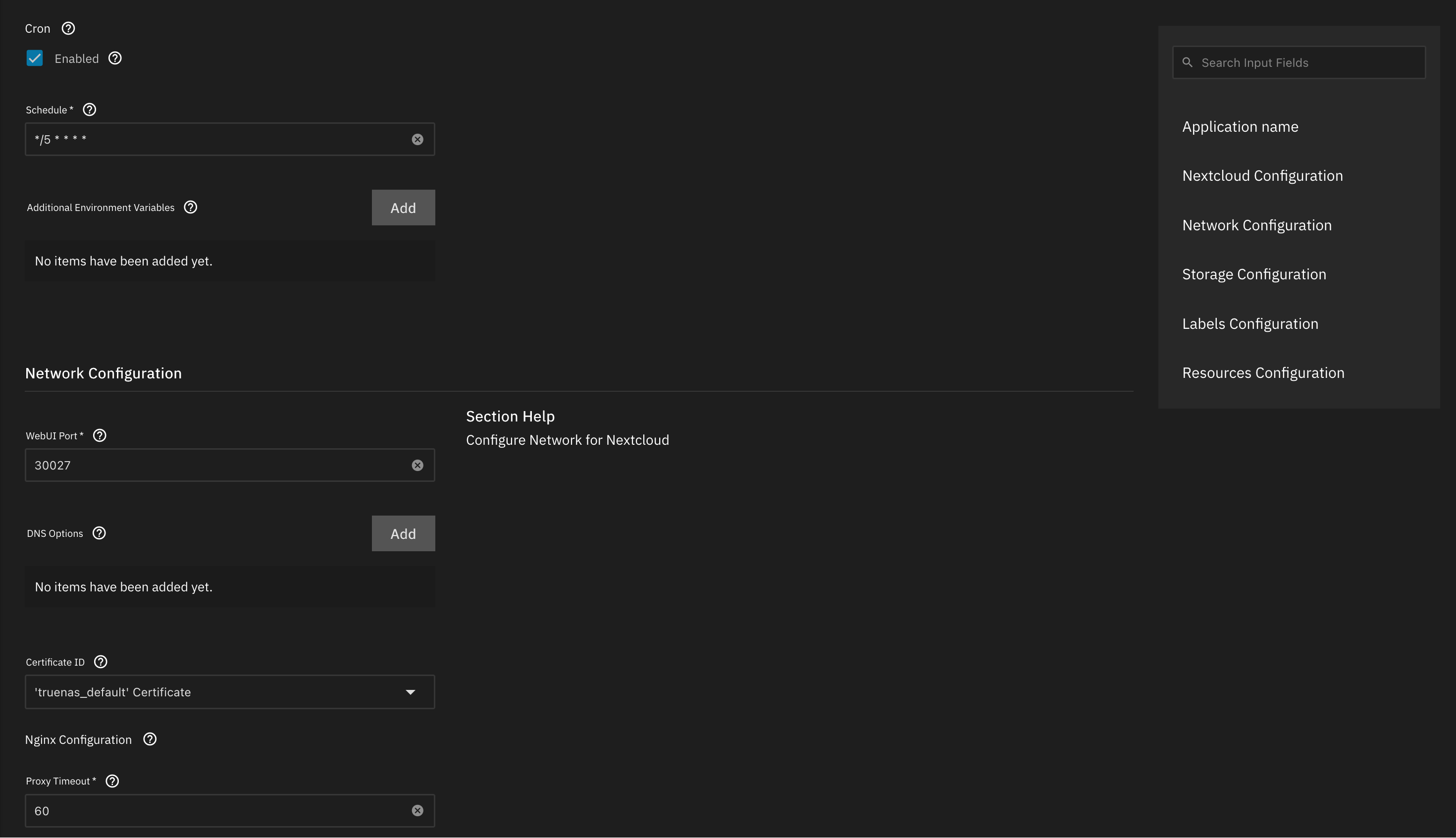

Ive tried to install Nextcloud, but im running into a little problem.
My TrueNAS Server runs on the IP 192.168.178.250 and ive set the Nextcloud IP during the installation to 192.168.178.251 but im getting a timeout error.
I have tried adding the port, but i doesnt makes any difference

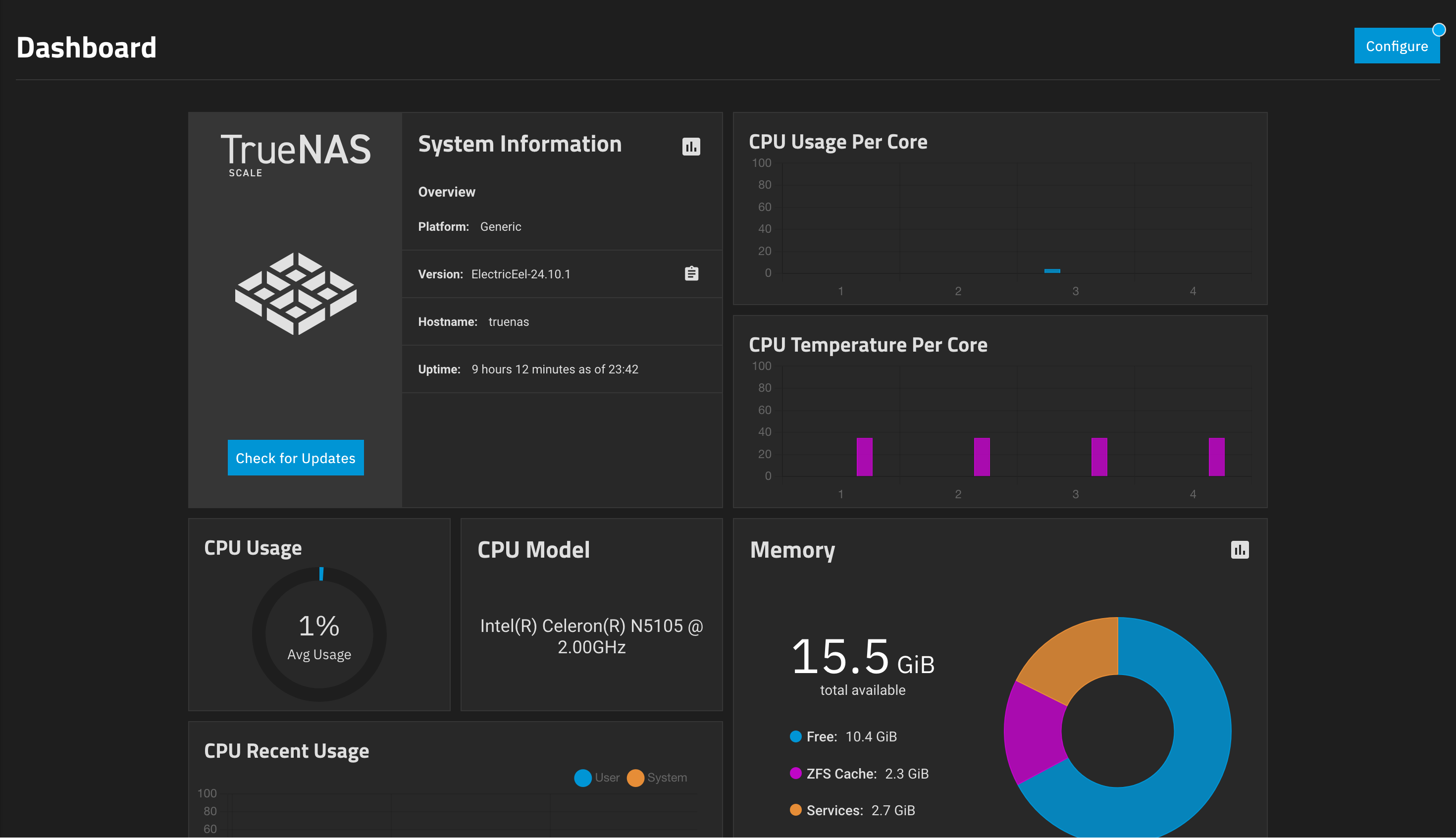

In order to be able to help you with an app issue we need to know which version of TrueNAS you have as well as exactly how you set Nextcloud up.
You mentioning assigning a different IP to Nextcloud makes me think you have an older version of SCALE or at the very least set Nextcloud up in a non-standard way.

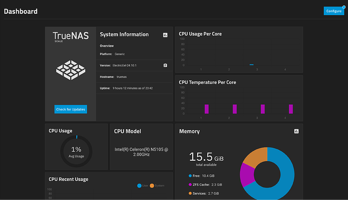

I am running ElectricEel-24.10.1.

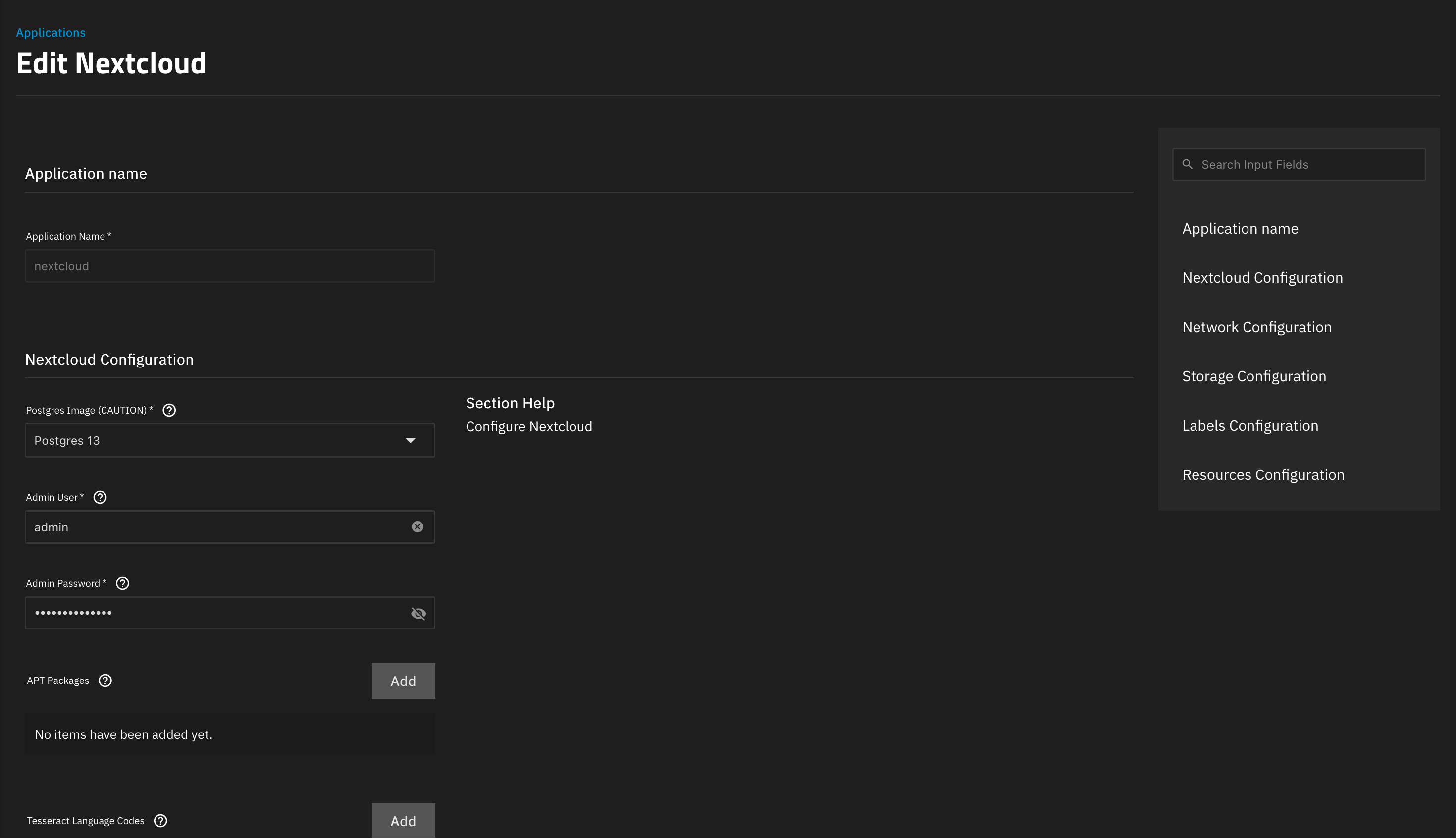

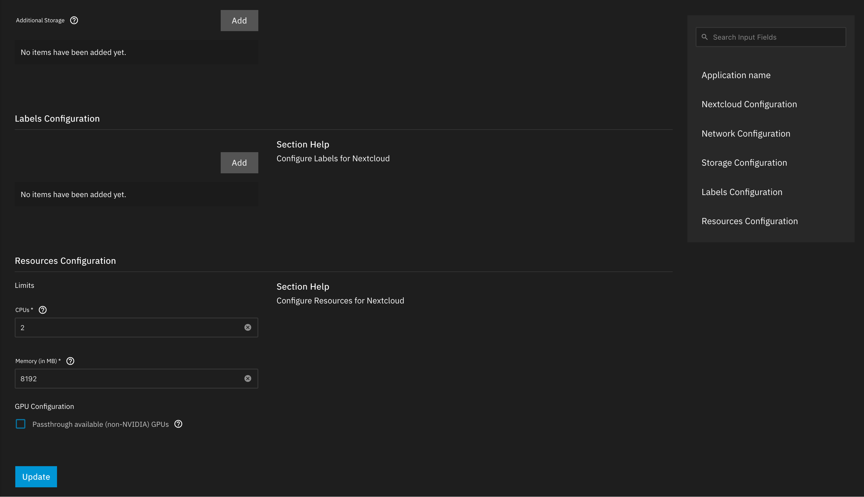

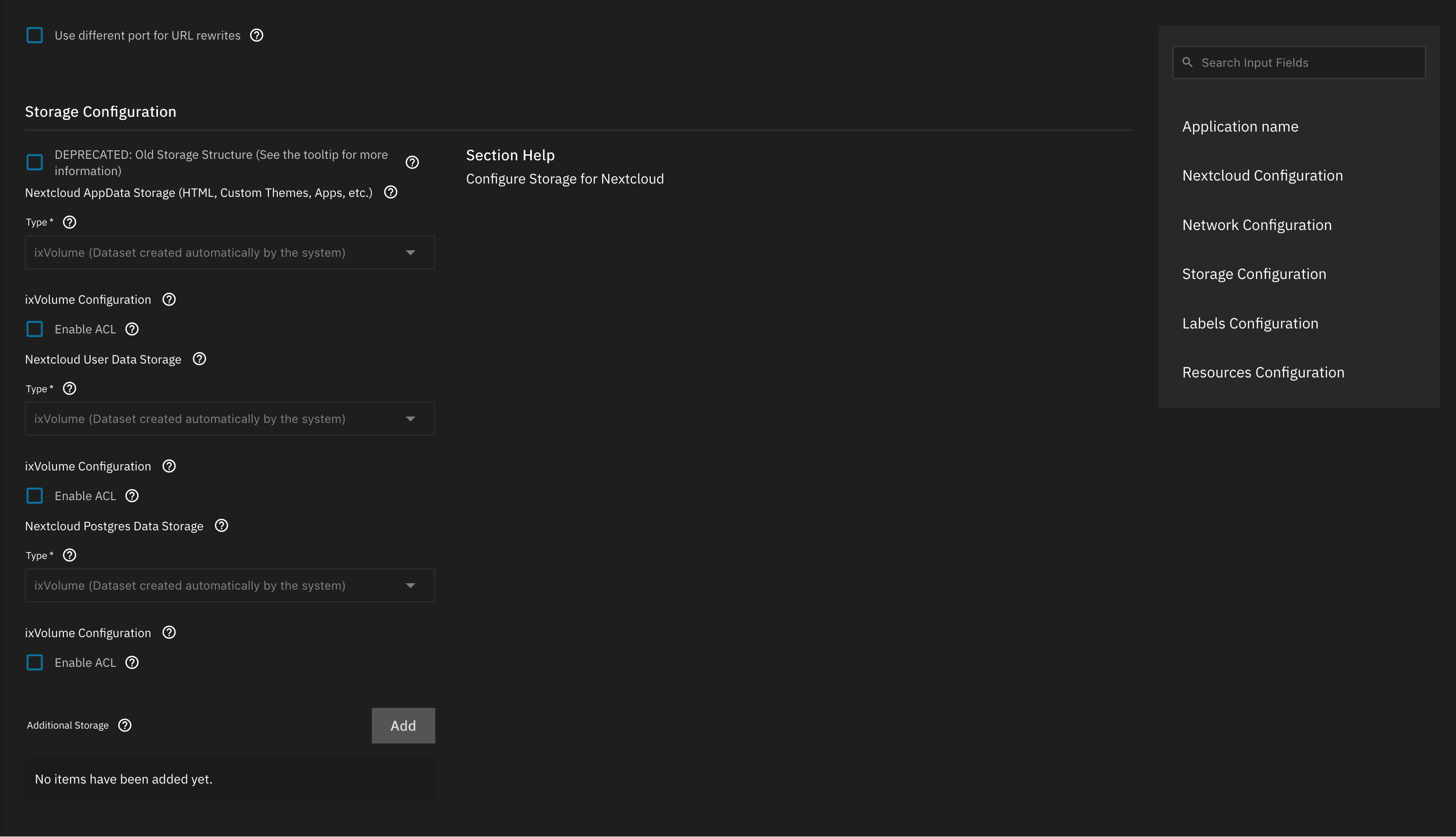

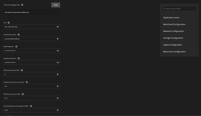

Here are some Screenshots of my Nextcloud installation.
I’ve set the Nextcloud IP to the same as my Truenas Server, but I am still getting the same error
I see a lot of ixVolumes there, those are not supposed to be used for anything but a test, as any data stored there is volatile at best.
Please read the documentation, especially the bit explaining storage volumes and associated datasets:
Also, when setting up host paths, make sure have the correct permissions set up, this might help explain how to do that:

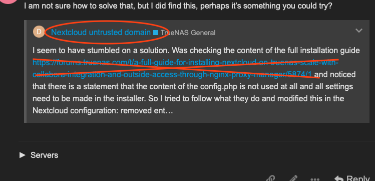

But now, I get redirected to the TrueNAS Login Page under 192.168.178.250 when I try to access Nextcloud over 192.168.178.250:30027

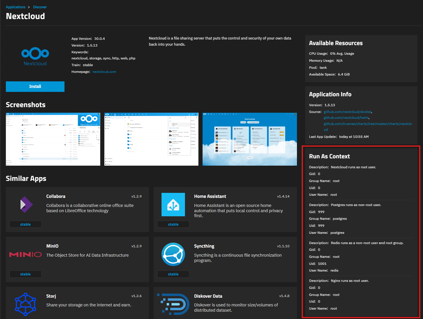

I am not sure how to solve that, but I did find this, perhaps it’s something you could try?
Mhhhhh. I am not really sure how to use this post in relation to my Problem. Do you know if there is an .htaccess in the nextcloud installation? Maybe something is wrong there, because i instantly get redirected to the Host IP. Other Apps work just fine.
Which link did you click?
htaccess is not mentioned in the topic I linked.
This is the thread I suggested you read, circled in red:
OMG Thanks!
This worked for me!
