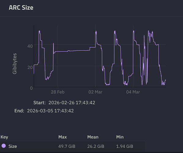

I have mentioned that is behaves differently. I seem to stay at about 50% of RAM as ARC with how I use TrueNAS. It also likes to flush out ARC from RAM for no apparent reason, sometimes. My system is idle overnight and it does an ARC flush? The adaptive ARC is a bit odd to me.

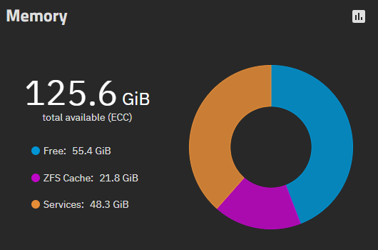

Eh, not really. Closer, yes, but definitely not the same. Here’s my (main) 25.04 system, with about two months’ uptime:

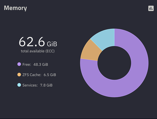

And my backup system on 25.10.2:
Hmm i wonder what’s different with my system. That picture is with 7 days uptime after the last truenas update
How is your system used? Mine is mostly idle unless I am syncing files over SMB from my Windows 11 computer. I use robocopy to backup / sync about 13 TB of files.
There are no Apps nor VMs. Mine is just storage.

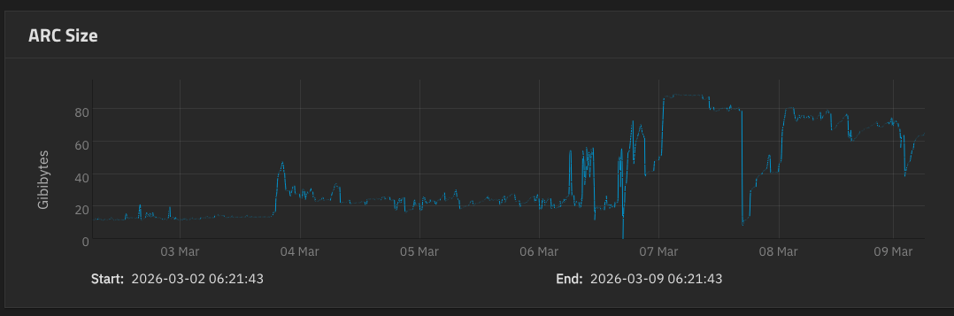

My Arc Size graph looks quiet different
The low part at the beginning was when i updated to 25.10.2.1 last week, other then that its almost completely stable, only a difference of 3GiB over the whole week

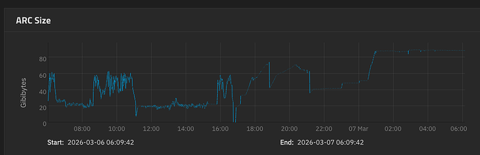

I installed that yesterday afternoon, and this morning, I see this:
Encouraging. Let’s see if the periodic ARC flushes have gone away.
Keep us updated pls.
After a couple of days, not as encouraging:
