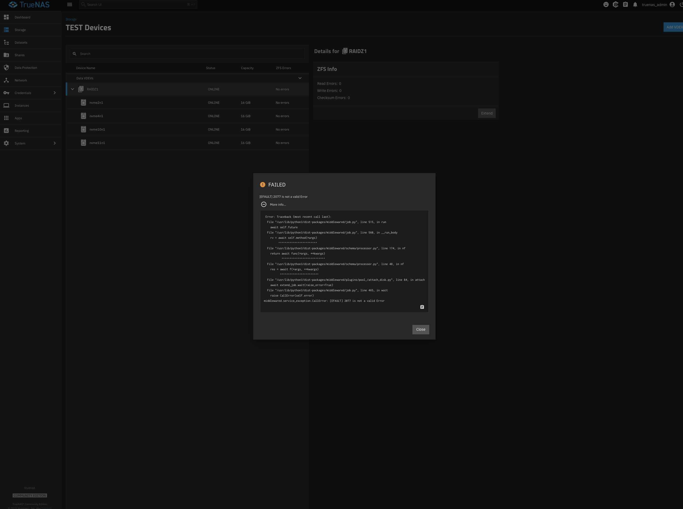

Can you extend a pool with a checkpoint in place? I’ve never tried it.
Should be able to.

I feel like you can’t but I’d need to check to be sure. If it works then it’s a neat idea.
Yeah no joys. I think this happens for the same reason hot-spares don’t work and you can’t replace a drive that has gone offline when a checkpoint exists.

It appears that you can’t extend a pool while a checkpoint is in place. Therefore the extend would fail and the checkpoint would be of no use.

No sorry I tried an extend and it failed.

Extend a vdev.
Right. That won’t work with checkpoints.
