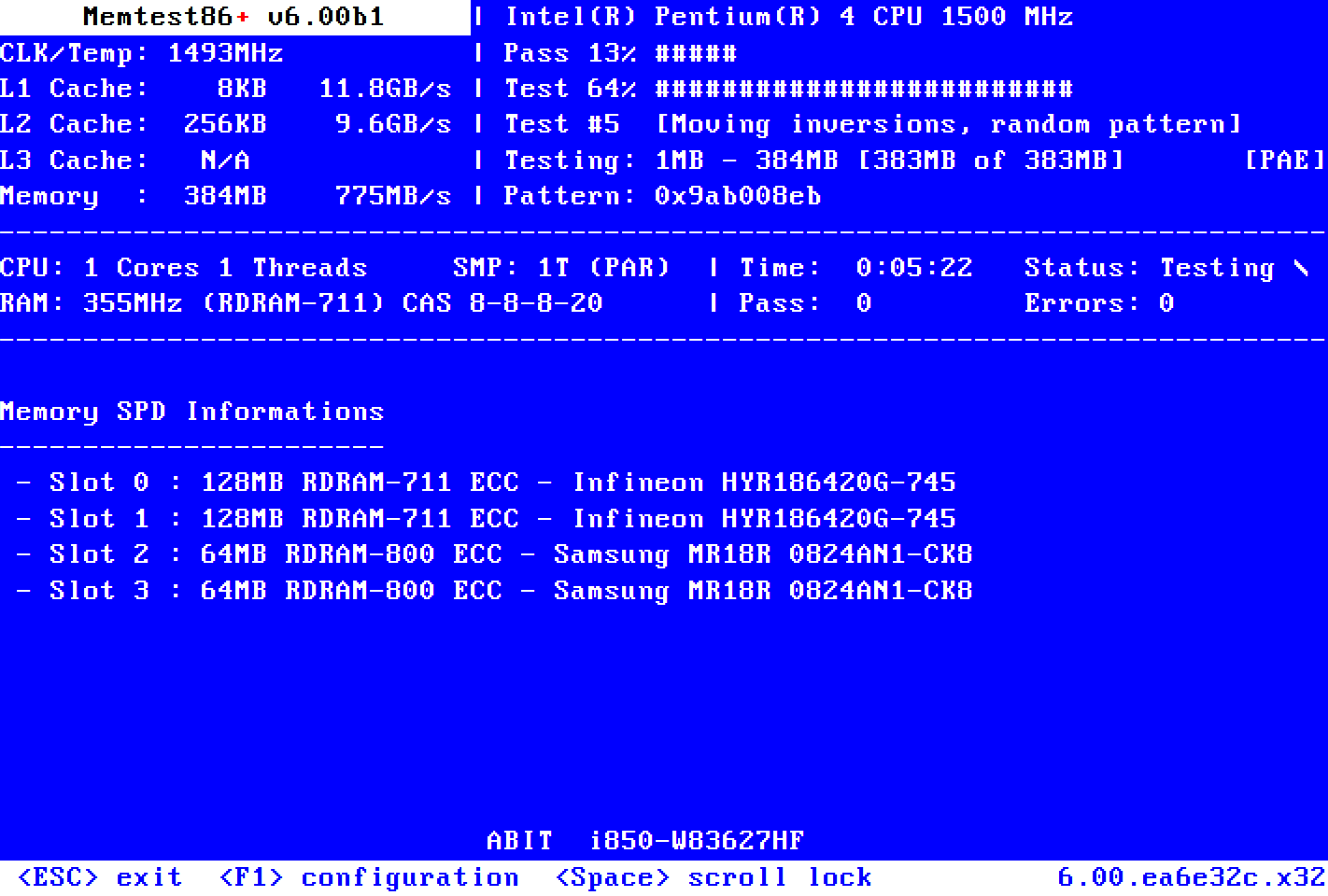

I highly recommend you run MemTest86+ on your system for several days to rule out a possibly memory issue. One complete pass is never enough, go for at least 5 complete passes. That is my criteria.

I don’t think the physical drives at fault. It could be any other piece of hardware though. It may be much faster to boot up MemTest86+ (free) and let that run for a few days. I think you will make better use of your time. If it passes, you have ruled one thing out as not the problem. Again, at least 5 complete passes, one is not enough. If it takes 5 days, then it takes 5 days. What is your data worth.

Some rounds of MemTest86(+) are definelty a good idead.
You error description above leads in this direction.
CPU (memory controller), Mainboard or RAM could have issues.
