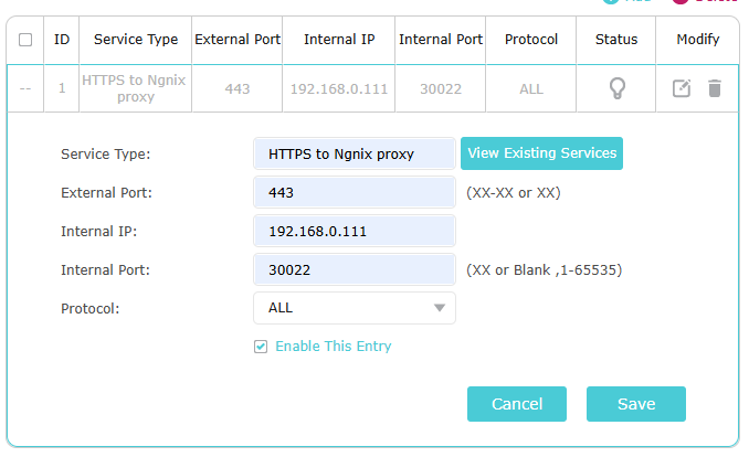

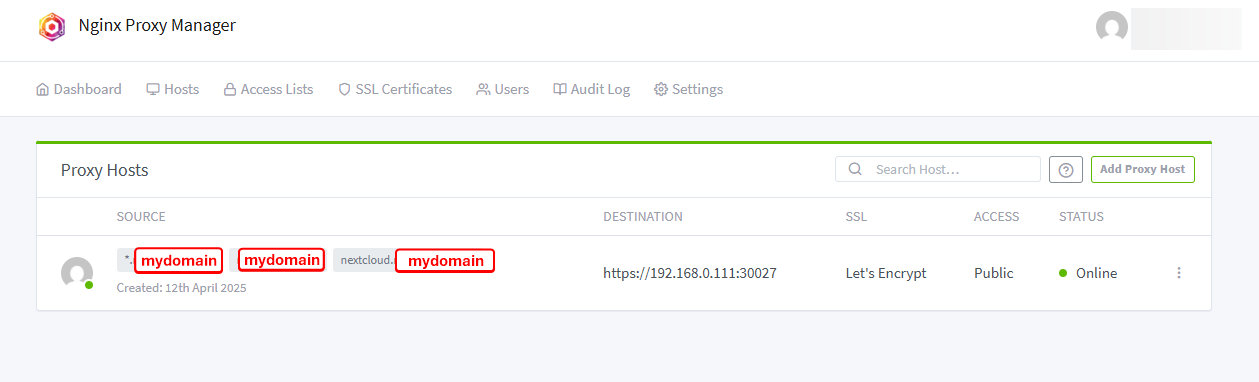

I have removed the Cloudflare tunnel and setup port forwarding on my router:
Ngnix Proxy Manager

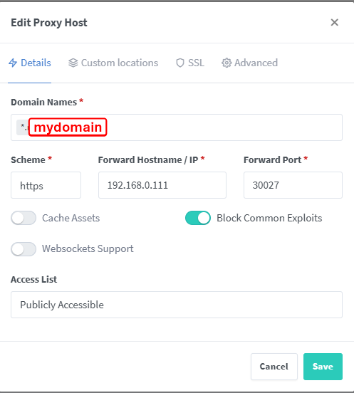

I have modified the proxy host as follows:
Nextcloud install:
Host: blank
Environment variable: OVERWRITEHOST - value: nextcloud.mydomain
Certificate: ‘truenas_default’ Certificate (use different port for URL rewrites is NOT CHECKED)

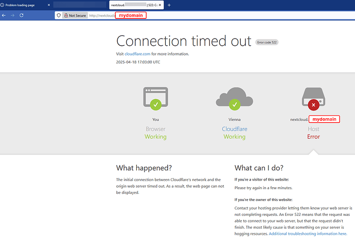

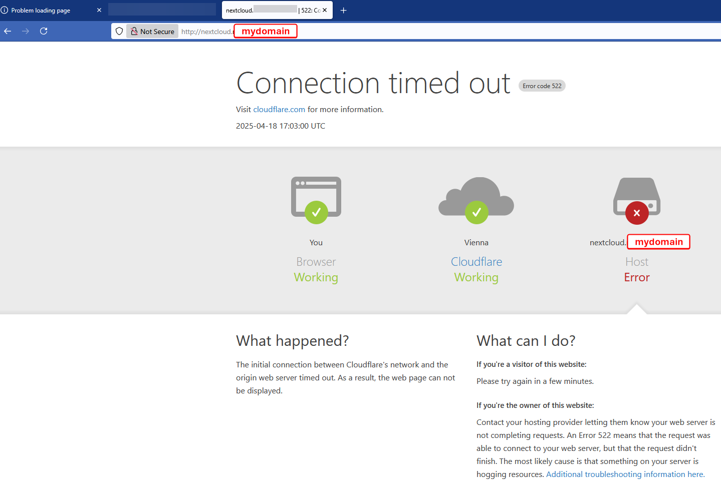

I’m still getting the same error with “Connection timed out Error code 522”
Thank you for any suggestion / correction to make my setup a working one.

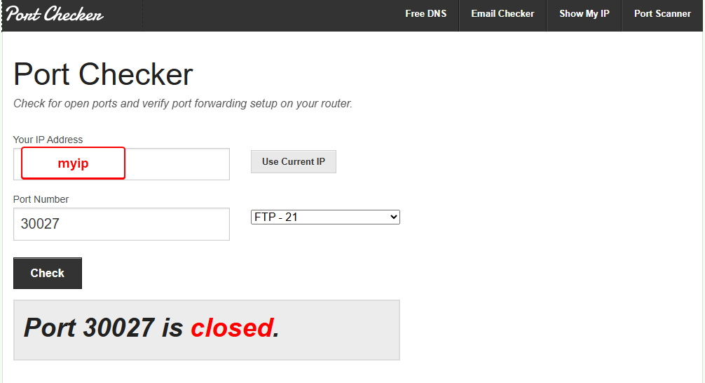

I have checked the port 30027 (nextcloud) and 30022 (ngnix) on Port Checker - Check Open Ports Online and both are closed with my current IP:
Port 80 is also closed but 443 is open.
I also checked with the IP indicated on Cloudflare DNS page: ports 443, 80, 30027, 30022 are closed.
What can I do?

Your results are actually pretty promising. It is important to understand the difference between internal and external ports. When you set up the port forwarding rule on your router, you forwarded external port 443 to internal port 30022 of your Nginx Proxy Manager device:
This is why it’s called port forwarding. You are redirecting all outside traffic that comes in on external port 443 to your Nginx Proxy Manager internal IP (192.168.0.111) and port (30022). Depending on the exact URL entered by the user, Nginx Proxy Manager then redirects incoming traffic again to another internal IP and port, based on the configurations of your proxy hosts. As far as the outside world is concerned, though, the only open port should be port 443, so the fact that ports 80, 30022 and 30027 are closed is a good sign.
This is also what is so great about a reverse proxy. Without it, you would need to open a unique port for every service that you want to access from the outside world, which is not only a security risk, but also means that you would need to remember each service’s unique port number. With a reverse proxy, however, you only need to open one port (443), you can specify memorable subdomains for each service (e.g., nextcloud.mydomain) and any incoming traffic that doesn’t match any of the subdomains that you have set up in your proxy hosts will simply be blocked.
Anyway, two things from your response jump out to me:
  • You should be checking not only whether port 443 is open for your external IP address, but also whether port 443 is open for your domain (the tool can test both domains as well as IP addresses, even though the fact that it says Your IP Address makes it seem like it can only test IPs).
    • If you find that the tool reports that port 443 is open for your external IP but closed for your domain, then we could almost certainly conclude that the issue is with your DNS configuration.
  • Assuming that you have already changed the domain name in your A record on your DNS configuration page from mydomain to *.mydomain, you also need to ensure that the A record is pointing to your external IP address. The fact that you said this…
    …made it sound like your actual IP and the IP listed in the A record in your DNS configuration are different, which would be wrong. The IP indicated on the Cloudflare DNS page should be your external IP.
    • If you have a dynamic IP address, then now would also be a good time to ensure that you have some type of working DDNS (Dynamic DNS) solution. Otherwise, the link between your domain and your IP address will be severed (and will need to be manually updated) each time your IP address changes. Since you are using Cloudflare for DNS, this page on Cloudflare’s website mentions two options for setting up DDNS with them. If that is too technical for you, then you may want to look into which DDNS providers, if any, your router natively supports and then switch over to one of those providers (this would also allow you to run DDNS entirely from your router, thus avoiding the need to run a script on another one of your devices).

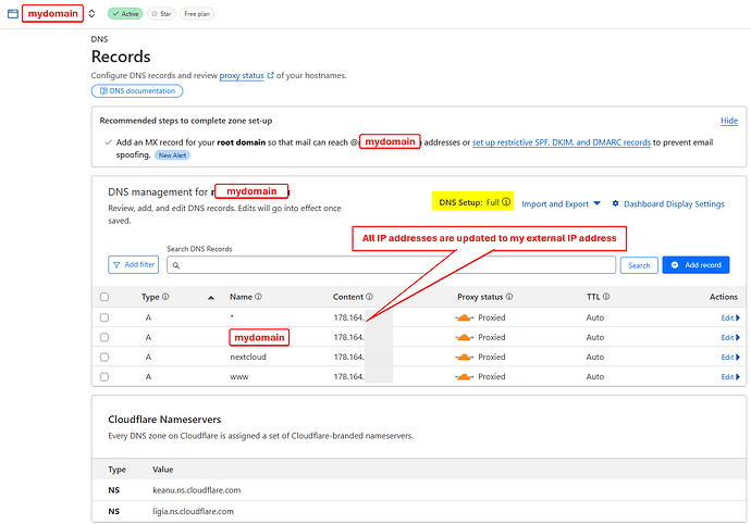

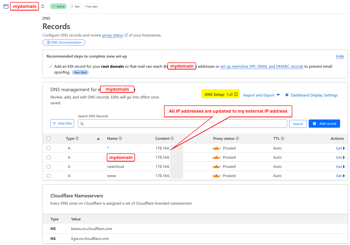

See my DNS setup on Cloudflare:
I hope this issue can be somehow sorted out.
Thank you for the advice.
@gm_home
I dug into your specific situation a little more. According to this comment by michael-pellegrini in oznu’s GitHub repository for docker-cloudflare-ddns, the right way to setup Dynamic DNS for all subdomains of your domain is to add this additional field under environment: (right below - ZONE=mydomain):
- SUBDOMAIN=*
However, he also points out that doing this will remove Dynamic DNS for just the domain itself (without any subdomains). Directly below, favonia points out that this is a known limitation of the tool, referencing this thread.
If you need Dynamic DNS for your domain and its subdomains, then it looks like you will need to find a different solution. Otherwise, I would recommend adding that - SUBDOMAIN=* line to your yaml and removing all A records besides the one for your wildcard domain (with name *).

I have found another solution: GitHub - favonia/cloudflare-ddns: 🌟 A small, feature-rich, and robust Cloudflare DDNS updater
It’s constantly running and it updated my IP addresses on Cloudflare DNS record page to my external IP - so this is success.
The DDNS part seems working but I still get the same error message. When I simply enter nextcloud.mydomain to the browser it still displays the page with http:

I also noticed that in your most recent screenshot, a connection was attempted over http instead of https. This suggests that there might be a problem with your SSL certificate. You haven’t mentioned how you are trying to generate an SSL certificate, so I would be curious to see your solution for that. You are also more than welcome to post your configurations for anything else in your current setup.

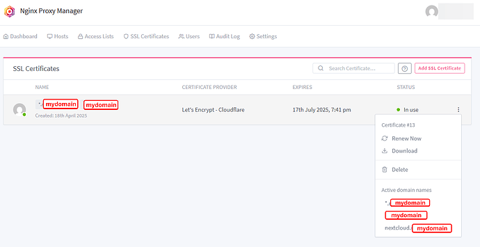

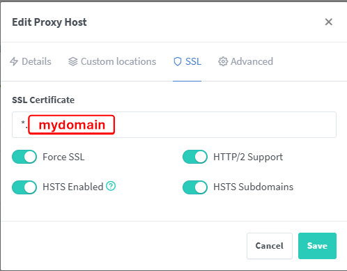

I have had already created the SSL certificate based on the guide you also provided: HomeLab: Nginx-Proxy-Manager: Setup SSL Certificate with Domain Name in Cloudflare DNS | by Life-is-short--so--enjoy-it | Medium

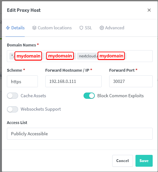

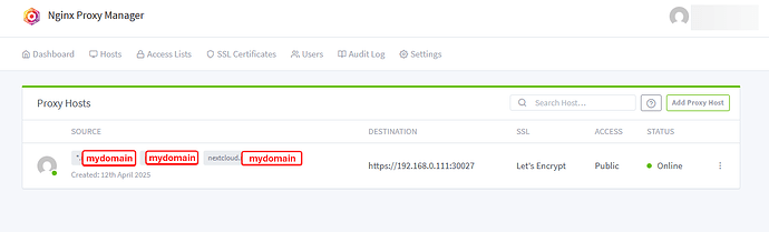

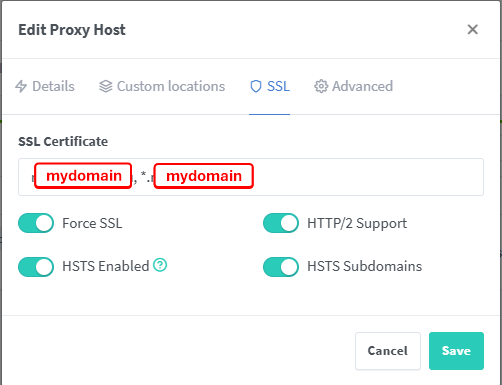

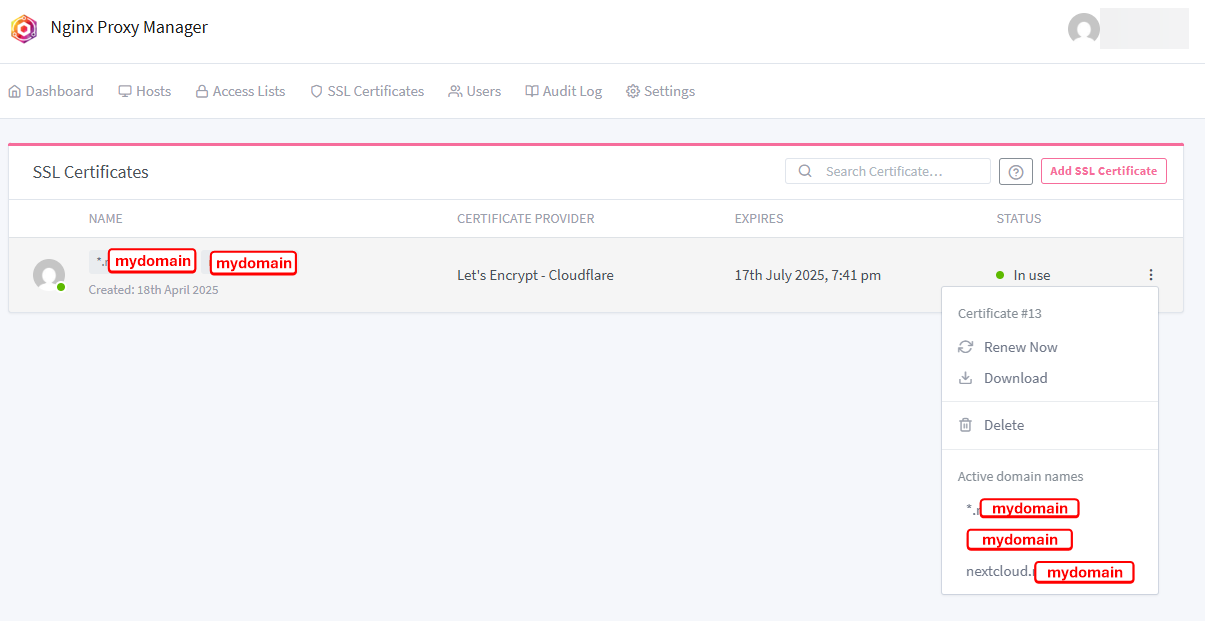

Let me summarize my configuration:
SSL certificate
The Cloudflare DDNS updater is working, port forwarding to Ngnix proxy is also set on the router:
Am I missing something or configured incorrectly?
Thank you again for the checks and sorry for the many screenshots.
@gm_home
Your configuration seems more or less correct. Again, the only things I would try would be:
  • Removing mydomain and *.mydomain from your Domain Names in your proxy host configuration (leaving just nextcloud.mydomain)
  • Removing nextcloud.mydomain from your SSL certificate (leaving just mydomain and *.mydomain)
  • Removing the nextcloud and www A records (leaving just mydomain and *)
I don’t see why any of the aforementioned would necessarily pose a problem. I am just thinking that issues might be arising out of redundant name matches. For example, in your proxy host, SSL certificate and DNS configuration, the user-entered URL of nextcloud.mydomain would satisfy the conditions of both nextcloud.mydomain and *.mydomain, so changing things such that only one field could ever match a specific URL might make the server less “confused”.
Even if this isn’t causing any errors, there is no point in having nextcloud.mydomain in your SSL certificate, since that would already be caught by the wildcard (*.mydomain). Similarly, there is no point in having explicit A records for nextcloud and www, since those would be caught by the wildcard A record (*).
