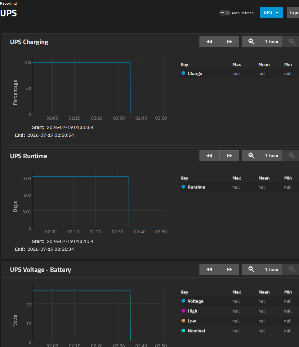

I had a power cut last night for approx an hour UPS went into OB mode as expected and ran on batteries for about 40 min, but shutdown command was not issued upon low battery. The reporting graph shows USB charging at 100% before pulling the plug and powering off everything ungracefully.
Power cut began at 01:55 and was fixed 02:53
NUT is configured with TrueNAS as master and OPNsense as guest plus a network switch that connects them all together.
Both TrueNAS and OPNsense PC’s BIOS’s are configured to turn back on upon power loss, but my expectation was both machines would stay off when a shutdown command is issued as its not a power loss event
I changed the shutdown mode to “UPS goes on battery” this morning and ran a test which worked correctly.
Is this a TrueNAS Scale bug, a UPS one, or am I interpreting things incorrectly?

I don’t understand why the UPS charging graph stays at 100% while draining the battery in OB mode. My expectation would be it would slowly reduce as the battery is drained triggering the shutdown command when it reaches 10%
Isn’t the charging graph where TrueNAS’s NUT service calculates when it reaches 10% or is that done in the UPS?

I can’t work it out. AI says shutdown is calculated from the UPS voltage yet the NUT graphs show a steady voltage all the time it was on batteries before dropping instantly to 0.
