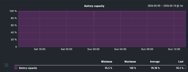

Here’s a graph of the battery capacity over the last 25 hours from my monitoring:
Today was especially annoying as I received ~50 mails about low battery.
