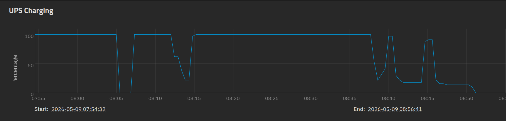

The system shuts down from time to time, but there hasn’t been a power outage. Here is the UPS report; maybe there’s something I’m missing.
The other devices connected to the UPS did not shut down. Industrial production never really came to a halt.

Could be unrelated but my ups does a battery and selftest every 10 or 14 days or whatever, and with truenas shutdown mode set to “ups goes on battery” whenever the ups would self test the server would shut down pretty much immediately, even with a 600 second shutdown delay. After switching to “ups reaches low battery” I have had multiple continuous weeks and sometimes over a month of uptime (usually it’s drives or hardware being stupid requiring a reset or shutdown and troubleshoot). If your ups service is on “goes on battery” you might try switching to “reaches low battery" to see if it fixes it to narrow down if it’s a hardware or software issue.
