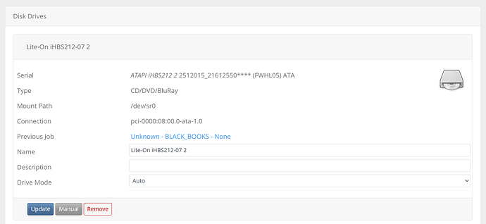

I’m using Automatic Ripping Machine (App Version: v2.23.2 / TrueNAS App Version: v1.1.7) on my TrueNAS CE 25.04.2.6 build.
I’ve been able to rip a DVD sucessfully, however after the first rip all susequent rips fail with loged error “A fatal error has occurred and ARM is exiting”.
To get it to successfully rip again I have to power cycle the whole machine and then ARM works again, but only for one more rip and then a power cycle is required again. I’ve tried restarting only the ARM app but it still fails, so I suspect it’s something to do with the OS or mounting.
Hopefully somone can illuminate me to why this is happening?

return run(*popenargs, stdout=PIPE, timeout=timeout, check=True,
File “/usr/lib/python3.10/subprocess.py”, line 526, in run
raise CalledProcessError(retcode, process.args,
subprocess.CalledProcessError: Command ‘[‘findmnt’, ‘–json’, ‘/dev/sr0’]’ returned non-zero exit status 1.
04-19-2026 09:18:34 ARM: ERROR: Disc was not and could not be mounted. Rip might fail.
04-19-2026 09:18:34 ARM: INFO: Disc title ‘None’ not searched in database
04-19-2026 09:18:34 ARM: CRITICAL: A fatal error has occurred and ARM is exiting.
04-19-2026 09:18:34 ARM: CRITICAL: Could not determine disc type
04-19-2026 09:18:37 ARM: INFO: Releasing current job from drive
I’m not sure if it’s of any relation but if I boot the NAS with a DVD disk already inserted I see the drive info in ARM Settings, like this:
But if I boot without a disk inserted or insert a disk post-boot it always looks like this:
looks like it fails to mount the usb drive you passed through.
As to why it fails, i don’t know
Yeah I noticed that, but I dismissed it as it says “Rip might fail” and is common to both successful and unsuccessful rips. I also assumed everyone with a read-only disk inserted will get that error?
Also I’m using a SATA drive (not USB) if that makes any difference.
Ok, i assumed it was usb because many use all available sata ports for their storage disks.
