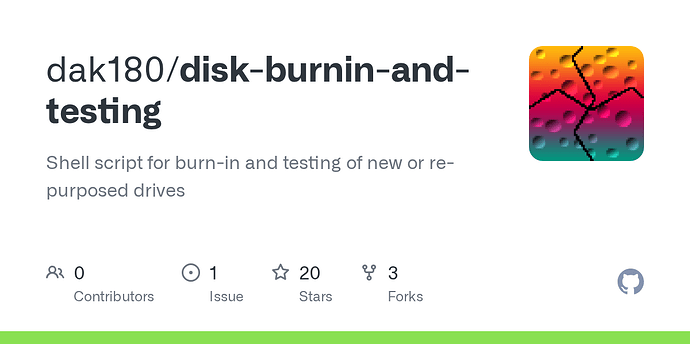

Yes. There’s a script to handle it, including choosing an appropriate block size, putting it all into a nice tmux session for you:

…or just use the script I linked up-thread, which puts it under tmux automatically.
