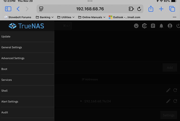

My screen looks different from yours. When I click on system here is what I see.
I do have a Network tab to click on but I don’t see any DNS settings.
I can access the manual updates.

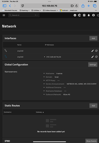

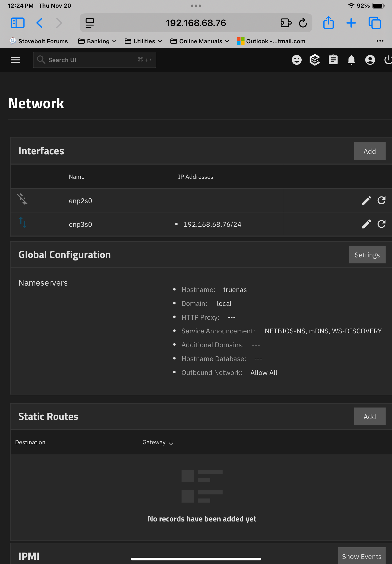

Okay, you will need to click on Global Configuration and select Settings. Then, you should see a screen on the side that looks like this:
The highlighted section is where you put in the DNS servers and the gateway.
If you’re not sure what to set them to I recommend that you set the primary DNS server and Gateway to the IP of your router. Your router will in most home setups be able to pass DNS requests on to whatever your ISP uses.

I added the Primary DNS to TrueNas and it now allows the update. It wants me to update to 25.04.2.6. Should I follow the update path, or can I go directly to 25.10?

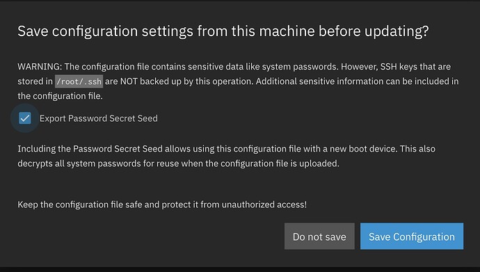

Also should I save my configuration each update? It gives me a warning about SSH keys and secret seed which I don’t understand.

If you want the best practice opinion, you should always backup the config and secret seed to be saved somewhere safe. You won’t need it until you need it.
If you’re using encrypted datasets, you should also backup the keys.
