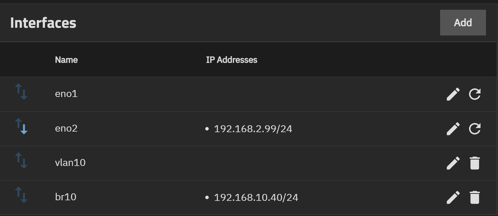

I am in the nightmare of trying to setup OPNsense and Unifi (my advice is don’t do it at this point). So I’m in a never-ending loop of issues. SO, I’m trying to get the Unifi controller running as a “container” in Scale 25.04.2.3. So with that in mind it looks like I want to create a bridge for that to communicate on.
Overall goal: Setup the container with a static IP that shows up so that I can point the Unifi switch to it as the controller, so I can manage the switch, to then connect to the OPNsense router.
So I have:
br10 with the static IP (192.168.10.40) has vlan10 as a member
vlan10 with a tag of 10 is on eno1 as a parent interface
eno1 is there as an interface
I am trying to connect through a switch only with my laptop and I can’t for the life of me connect to the interface on the IP. It works fine switching to the other NIC as a backup.
I have tried rebooting the NAS a couple times, I have rebooted my laptop. Nothing seems to be working. When I had it set on the interface, it seemed to work fine. Really not sure what else to try. Happy to run any commands.

Cavaeat: I’m not running scale (still on core), so I’m making some assumptions based on that screen.
My switch is a Unifi switch that I can’t really access the mgmt of at the moment because I bought a switch I need to be able to create a controller for before I can get anything to work (not loving Unifi right now), so am trying to take any weird switch config out of the equation I am using an unmanaged switch as it’s my understanding that it should at least let me connect (I was trying through the managed switch as well and that wasn’t working either even though I “think” I was going through two ports that should have been set for the mgmt VLAN.
My laptop is set to 192.168.10.x subnet. It could be a VLAN thing which sort of gets back to the chicken and egg thing of how do I set this switch up without the controller if I need the switch setup to get the controller online. If, from a setup perspective everything seems correct, then it’s probably just a weird networking thing that I need to get figured out.

Turned out this was a VLAN tagging issue. A classic Unifi chicken and egg problem where I was trying to get this setup to adopt and setup my unifi switch but needing a switch to do it.
I ended up buying a Unifi cloudkey, getting the switch setup properly with VLAN tagging at the port for the MGMT network that Truenas will run on. Then I was able to setup a bridge with the parent interface. I was also able to setup an additional VLAN for a secondary subnet on that parent interface as well. So seems like everything is working just fine.
