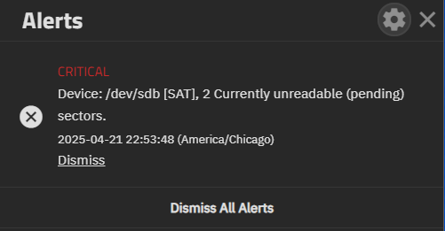

Currently Unreadable (pending) Sectors all over system
So my Truenas Build is new. This is quite a large system. I have been getting the 2 Currently unreadable (pending ) sectors error.
It is happening to random drives throughout the system.

So true… Before the ssd upgrade I was running sas drives, and, yes, ouch was the power bill. But on the other side the ssd’s even though there are 48+, its not to bad on power. On idle the entire system is only drawing 115-125 watts, and under load 175-200.
As requested.
This was the hdd I sent the screen shot in the post. This is a slightly older WD 4tb. Yes I know it is a purple drive. But I have a ton of these from a CCTV project, and I have found these to be the longest lasting drives I have encountered.

This was from the OS drive error I got yesterday.
Model Family:     Crucial/Micron Client SSDs
Device Model:     CT240BX500SSD1
Serial Number:    2448E9976742
LU WWN Device Id: 5 00a075 1e9976742
Firmware Version: M6CR056
User Capacity:    240,057,409,536 bytes [240 GB]
Sector Size:      512 bytes logical/physical
Rotation Rate:    Solid State Device
Form Factor:      2.5 inches
TRIM Command:     Available
Device is:        In smartctl database 7.3/5671
ATA Version is:   ACS-3 T13/2161-D revision 4
SATA Version is:  SATA 3.3, 6.0 Gb/s (current: 6.0 Gb/s)
Local Time is:    Tue Apr 22 09:01:57 2025 CDT
SMART support is: Enabled
AAM feature is:   Unavailable
APM feature is:   Unavailable
Rd look-ahead is: Enabled
Write cache is:   Enabled
DSN feature is:   Unavailable
ATA Security is:  Disabled, frozen [SEC2]
Wt Cache Reorder: Unavailable
See vendor-specific Attribute list for marginal Attributes.
General SMART Values:
Offline data collection status:  (0x00) Offline data collection activity
                                        was never started.
                                        Auto Offline Data Collection: Disabled.
Self-test execution status:      (   0) The previous self-test routine completed
                                        been run.
data collection:                (  120) seconds.
capabilities:                    (0x11) SMART execute Offline immediate.
                                        No Auto Offline data collection support.
                                        command.
                                        No Offline surface scan supported.
                                        Self-test supported.
                                        No Conveyance Self-test supported.
                                        No Selective Self-test supported.
SMART capabilities:            (0x0002) Does not save SMART data before
                                        entering power-saving mode.
Error logging capability:        (0x01) Error logging supported.
Short self-test routine
recommended polling time:        (   2) minutes.
Extended self-test routine
recommended polling time:        (  10) minutes.
ID# ATTRIBUTE_NAME          FLAGS    VALUE WORST THRESH FAIL RAW_VALUE
  1 Raw_Read_Error_Rate     POSR-K   100   100   000    -    0
  5 Reallocate_NAND_Blk_Cnt -O--CK   000   000   010    NOW  0
  9 Power_On_Hours          -O--CK   100   100   000    -    233
 12 Power_Cycle_Count       -O--CK   100   100   000    -    22
171 Program_Fail_Count      -O--CK   100   100   000    -    0
172 Erase_Fail_Count        -O--CK   100   100   000    -    0
173 Ave_Block-Erase_Count   -O--CK   100   100   000    -    1
174 Unexpect_Power_Loss_Ct  -O--CK   100   100   000    -    6
180 Unused_Reserve_NAND_Blk PO--CK   100   100   000    -    0
183 SATA_Interfac_Downshift -O--CK   100   100   000    -    0
184 Error_Correction_Count  -O--CK   100   100   000    -    0
187 Reported_Uncorrect      -O--CK   100   100   000    -    0
194 Temperature_Celsius     -O---K   074   070   000    -    26 (Min/Max 23/30)
196 Reallocated_Event_Count -O--CK   100   100   000    -    0
197 Current_Pending_ECC_Cnt -O--CK   100   100   000    -    0
198 Offline_Uncorrectable   ----CK   100   100   000    -    0
199 UDMA_CRC_Error_Count    -O--CK   100   100   000    -    0
202 Percent_Lifetime_Remain ----CK   100   100   001    -    0
206 Write_Error_Rate        -OSR--   100   100   000    -    0
210 Success_RAIN_Recov_Cnt  -O--CK   100   100   000    -    0
246 Total_LBAs_Written      -O--CK   100   100   000    -    27474878
247 Host_Program_Page_Count -O--CK   100   100   000    -    858589
248 FTL_Program_Page_Count  -O--CK   100   100   000    -    0
249 Unkn_CrucialMicron_Attr -O--CK   100   100   000    -    0
250 Read_Error_Retry_Rate   -O--CK   100   100   000    -    0
251 Unkn_CrucialMicron_Attr -O--CK   100   100   000    -    10629649
252 Unkn_CrucialMicron_Attr -O--CK   100   100   000    -    0
253 Unkn_CrucialMicron_Attr -O--CK   100   100   000    -    0
254 Unkn_CrucialMicron_Attr -O--CK   100   100   000    -    0
223 Unkn_CrucialMicron_Attr -O--CK   100   100   000    -    0
                            ||||||_ K auto-keep
                            |||||__ C event count
                            ||||___ R error rate
                            |||____ S speed/performance
                            ||_____ O updated online
                            |______ P prefailure warning
General Purpose Log Directory Version 1
SMART           Log Directory Version 1 [multi-sector log support]
Address    Access  R/W   Size  Description
0x00       GPL,SL  R/O      1  Log Directory
0x06           SL  R/O      1  SMART self-test log
0x07       GPL     R/O      1  Extended self-test log
0x10       GPL     R/O      1  NCQ Command Error log
0x11       GPL     R/O      1  SATA Phy Event Counters log
0x24       GPL     R/O     88  Current Device Internal Status Data log
0x30       GPL,SL  R/O      9  IDENTIFY DEVICE data log
0x80-0x9f  GPL,SL  R/W     16  Host vendor specific log
SMART Extended Comprehensive Error Log (GP Log 0x03) not supported
SMART Error Log not supported
SMART Extended Self-test Log Version: 1 (1 sectors)
No self-tests have been logged.  [To run self-tests, use: smartctl -t]
Selective Self-tests/Logging not supported
SCT Commands not supported
Device Statistics (GP/SMART Log 0x04) not supported
Pending Defects log (GP Log 0x0c) not supported
SATA Phy Event Counters (GP Log 0x11)
ID      Size     Value  Description
0x0001  4            0  Command failed due to ICRC error
0x0002  4            0  R_ERR response for data FIS
0x0005  4            0  R_ERR response for non-data FIS
0x000a  4            2  Device-to-host register FISes sent due to a COMRESET
And this last one is from one of the 4tb ssd’s in the large array which had this error this morning.

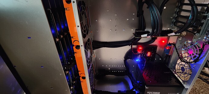

How are temperatures on the HBA and expander? Do these have direct cooling?
I have had colleagues flip me shit for using CCTV drives in my nas’s, from my experence over the years implementing large CCTV systems, I have come to respect the purple drives over almost any other spinning platters…
I keep the cases very tidy, and all the fans are upgraded to 3500 rpm pwm fans, so they can move an impressive amount of air. I have taken thermal shots of them at load. The hottest I have seen them is @49C/120F+/-
This is the controller.
Also one of the storage arrays.
I thought it might be thermals or something with the SAS untill I started getting the same errors on drive connected directly to the MB.

Ren a SMART Long test on this drive now. Hopefully it will pass.
The pending sector errors can go away but typically ID 5 will increment.
That should give you enough fuel to replace 2 drives.
That crucial ssd, that is an odd one. ID 5 Thresh is 010, the value reported is 000 whish is well below 010. It also tells you NOW!
Good luck
Interesting… That crucial drive is brand new, I will just send it back, since I have had it for like 7 days.
As for the purple I will run a long test on it tonight and get back to you. It is an older drive, so I can swap it if it needs.
What is your thoughts on the other one? I also get a few of the errors on that one, and i dont see any issues on 1 or 5 on it.
I do not see anything wrong with the SPCC drive. Disclaimer: I’m on my cellphone and without glasses. I can take another look at it after i get home. Run a long test as well.
