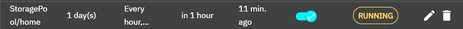

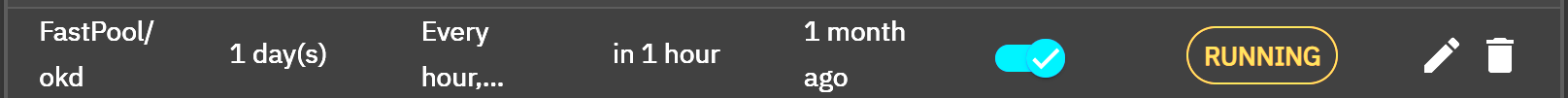

Basically what the title says. We have periodic snapshots (daily) for a number of datasets. Snapshot task on the WebUI always indicates either RUNNING or FINISHED but looking into it, we find no snapshots created. The last run column sometimes correctly mentions the time since last snapshot, other time it gives incorrect information.
Last Run column correctly showing last run as 1 month ago:
Last Run column showing incorrect value:
