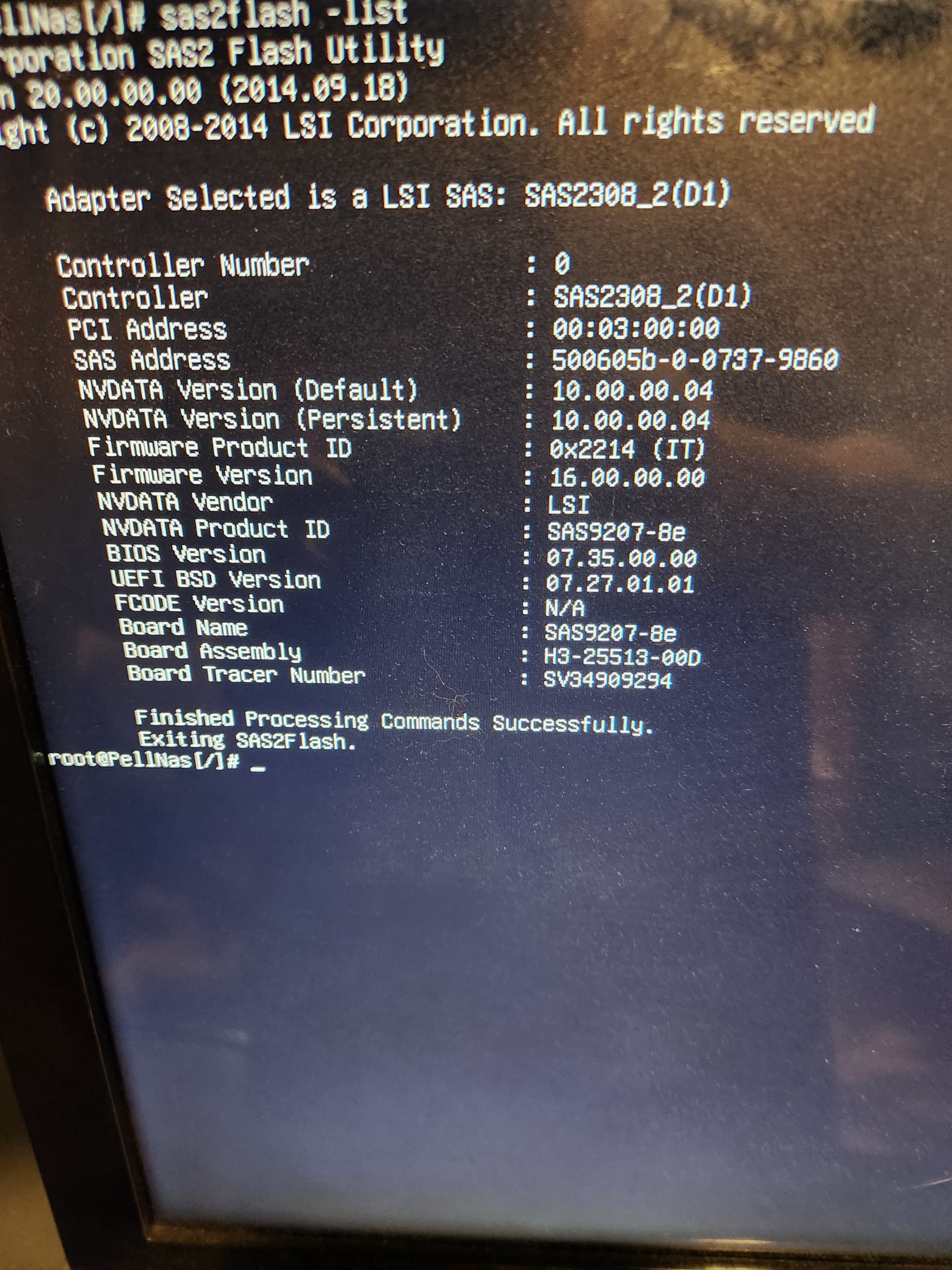

this is a screen shot of my sas2flash data for the card.

When that has been figured out don’t forget to update the firmware on that card, 16.00.00.00 is outdated. The 92xx series are typically on 20.00.07.00.

I would work on updating the firmware as @neofusion said above. It’s best to be on known good versions of the firmware.
updated the firmware, problem persists :frowning:

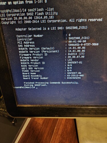

i upgraded the firmware, posted a screen shot above.
9207-8e still only seeing a single drive, this is not looking good :slight_smile:

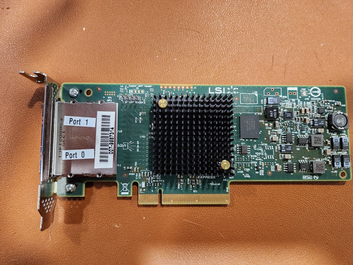

so in my reading last night, I learned that there are “counterfeit” cards out there and perhaps I received one of them :frowning:

Solved: I needed to install the UEFI BIOS and update the firmware to 20
