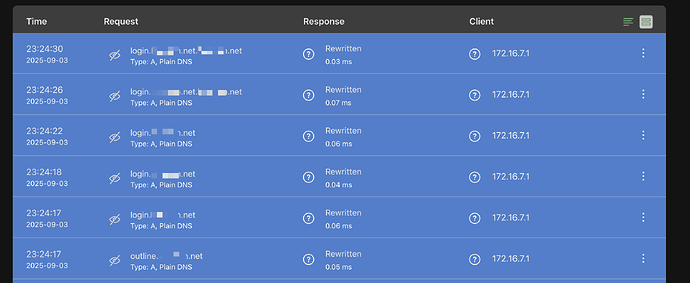

I just had a look in the log files for AdGuard. When I try to login, there are a series of DNS requests sent, where the last two probably hints at the root cause: The domain name is repeated twice. Probably due to a misconfig of mine, but I can’t figure out where. Have had a look both in my Outline and PockedID configuration and can’t find any place where I have repeated the domain name twice.
Could this be the problem?
Ok at least you know that the container Is using adguard (and i was totally wrong on that :smile: ).
But i don’t know if the repeated domain Is the culprit or a conseguence… Maybe the app perform some fallback when the first attempt fails? Why some entry Is well formatted and the last two no? :thinking:
Have you set some rewrite rule in npm?
If you try to lookup the domain from each container what Is the result?
