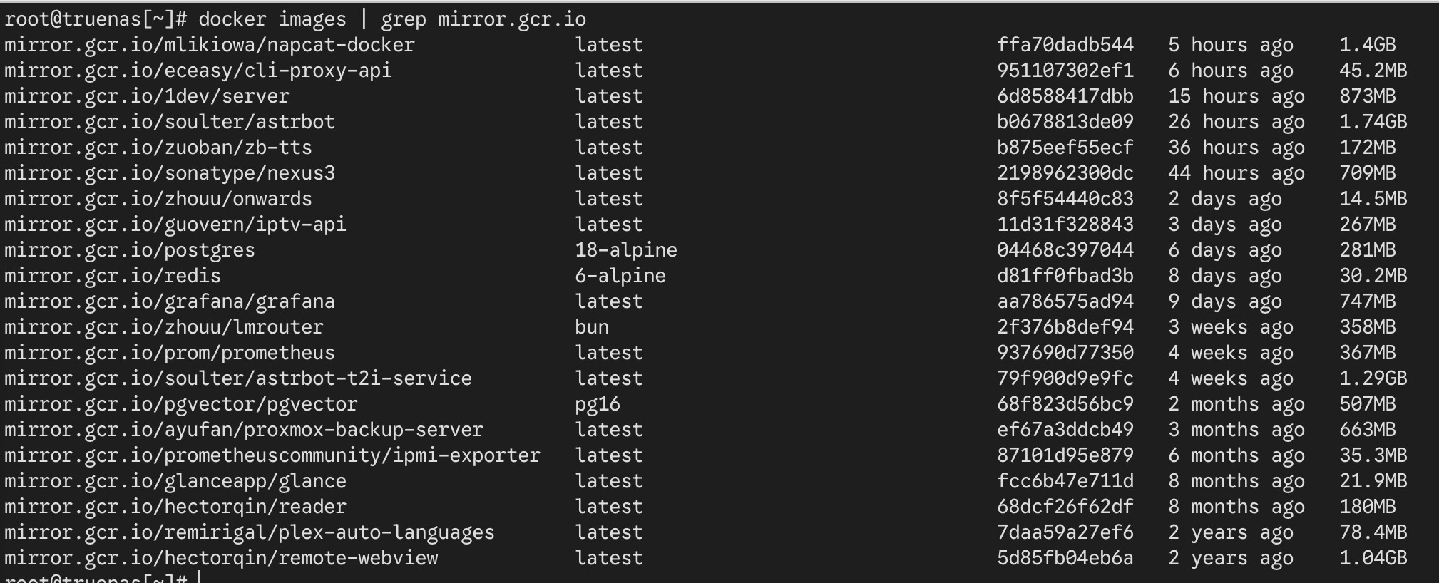

You can use mirror.gcr.io.

Also mirror.gcr.io should actually be https://mirror.gcr.io/ . as trying to just input it without the https:// results in an error. Warning: The moment you hit save setting it will instantly kill the docker app and with it all currently running apps.
