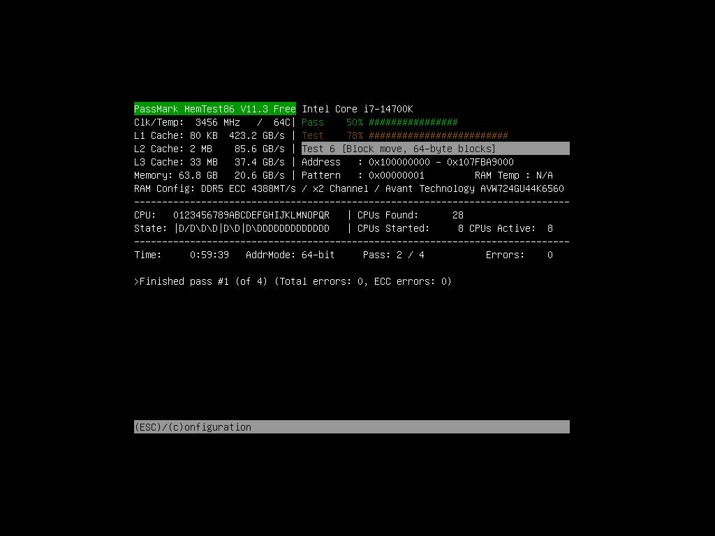

The case came in today, and I performed the first part of the assembly by installing the power supply and motherboard. I had the motherboard hooked up to HDMI, but I’m not getting video output. However, I did hook up a network cable to the IPMI port and was able to login and bring up a remote console. I’m running the first of two memory tests now.
