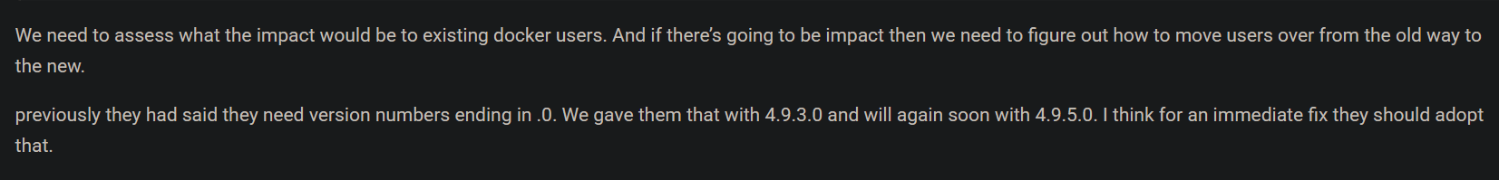

Right now they have been back to the previous scheme. The current stable version is 4.9.3.0 and the next one will be 4.9.5.0. while the current beta version for 4.9 is 4.9.4.1.
It should be able to conclude that stable version is 4.9.x.0, x is odd; beta version is 4.9.x.!0, x is even. Or you can even consider all the 4.9.x.0 as stable.
Could you please update your regex for fetching and see how it works? As the current fetching strategy doesn’t work, nothing can be hurt anymore.

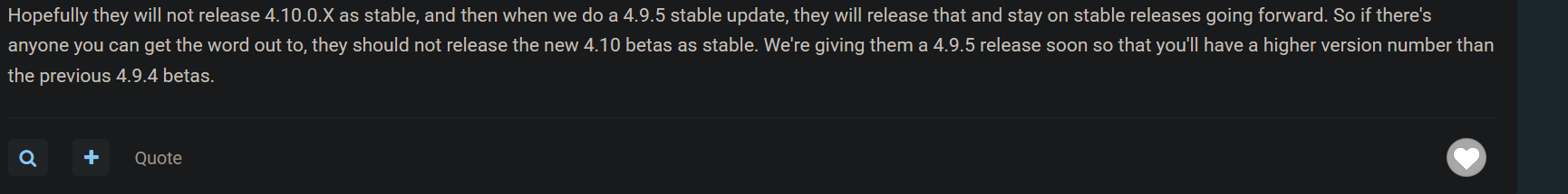

As for the 4.9.5 update that’s coming next being stable, that’s something he spoke about the other day.
I would like to point out that he’s simply naming the 4.9.5 update that’s coming as stable. He’s NOT saying that this is a new naming scheme. So for the future, there still needs to be a solution to differentiate between stable and beta.

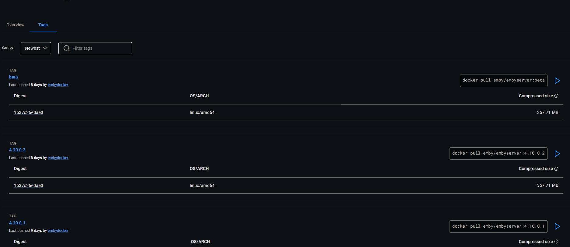

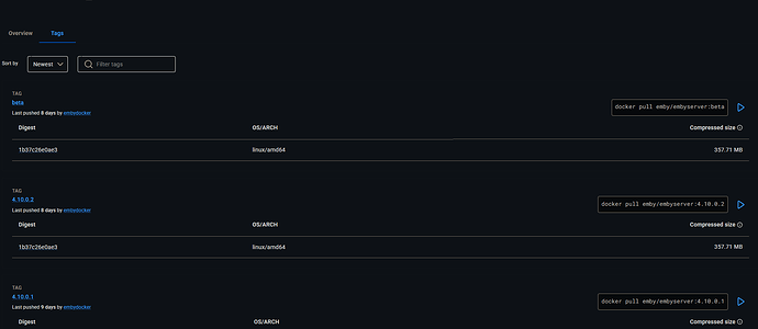

When i go to emby/embyserver - Docker Image i see that there is a tag for beta on the most recent update. Is this not how it’s always been @stavros-k ? Because if it’s not always been like this then there might have been a change the devs didn’t tell us.
As you can see in the screenshot, it clearly says beta there right below tag on the most recent update they pushed. The one before that has the same digest number but didn’t have the beta tag for some reason. So i’m not sure if it matters or not, i’ll leave it to you and other maintainers to make sense of it. And again, it would be cool if you guys could just join that thread on the Emby forums to talk to the devs directly, just do @ and luke and you’ll have a dev that sees your ping. Emby 4.9.1.0 Beta in TrueNas Community Edition 25.04 - Page 2 - Linux - Emby Community

He can correct me if I’m wrong but it feels like a lot of people are talking past each other here, so this is my understanding of the issue. :latest and :beta are both mutable. This doesn’t work for the TrueNAS apps catalog because the actual version being pulled by that tag can change without warning and the app maintainer does not get a chance to test or troubleshoot issues before rolling it out.
If you look at the screenshot someone posted in that thread:
three years ago emby apparently pushed an immutable beta tag for 4.8.0.30-beta, but since then has used the mutable beta.

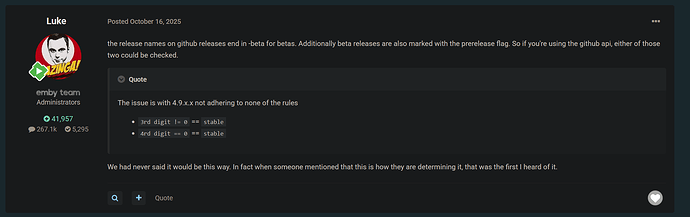

On github, I see that emby does use the -beta suffix in the titles of their releases, but even there the actual tag is just the numbers
https://github.com/MediaBrowser/Emby.Releases/releases/tag/4.10.0.2
If emby tagged their versions with that suffix 4.10.0.2-beta, the bot could ignore those, but since they tag both the beta 4.10.0.2 and stable 4.9.3.0 with the same format, the bot can’t tell the difference.

Luke responded to what i posted there from Djp with versionnumber-beta way of identifying releases. I just screenshot replies these days as i don’t want to risk messing up the back and forth with any words i might add that change the meaning.
