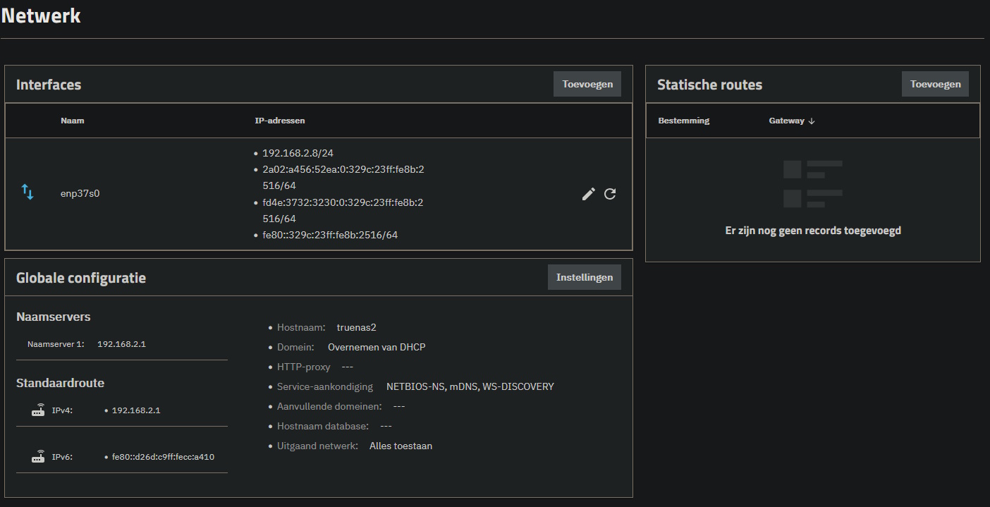

Please post a screenshot of the configuration you ended up with. The error points at a networking issue, so the Network-screen is the place to start.

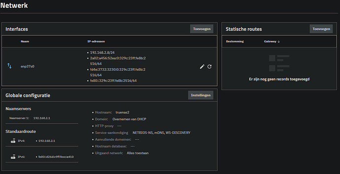

Tanks for your reply @neofusion. Here are my network settings. Any ideas?
Presumably 192.168.2.1 is the IP of your router?
That looks okay.
As long as you don’t have any static routes set on the right hand side of the Network screen.

Is 192.168.2.1 the IP of your router or your mothers router? If you’ve set it up with a static IP in your home and your mothers router uses a different subnet you have to adjust the network settings
This is a great point, you only posted a subset of the network page.
And validating that the specified gateway/DNS corresponds to the one in the house that the server now lives in is wise.

Yes, I can confirm that 192.168.2.1 is the routers address.
Of your mothers router? You didn’t really clarify that…
Sorry, yeah 192.168.2.1 is the IP from my mothers router.
Looks like it’s set to get an IP using DHCP.

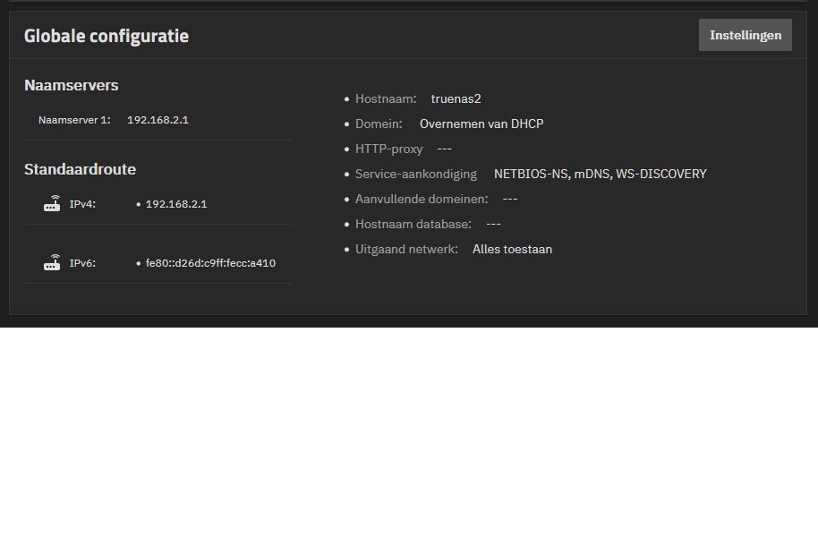

Can you confirm that the client system you’re using to connect to the server (and presumably write these posts with) also has 192.168.2.1 as router and DNS?
It’s odd that DHCP would seeming work, handing out the IP, gateway and DNS and then not be able to route any data outside your network. The TN-server is on your local network, since you are able to connect to it, but not much more than that.

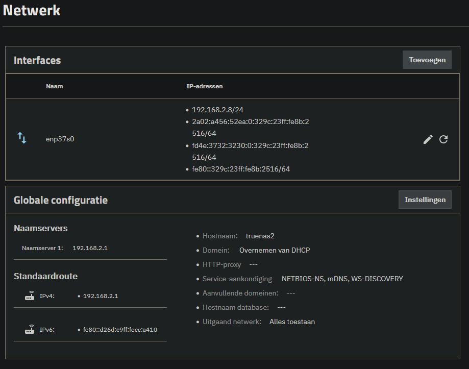

have been testing at my mother’s place. Tried switching on and off IPv6. Disabled DHCP and set a static IP. Took a look in the modem, set the IP from Truenas as DMZ, lowered the firewall settings. Even tried without Tailscale running. But no difference in the outcome. Still a failure notification when trying to update the appstore. Also, the response to ping 8.8.8.8 is still the same as before. The Tailscale config is default, as is my Tailscale at home. No problem to SSH trough Tailscale and do replication.
Also when trying if there is an update for Truenas, I get a failure response, see below. So I am at the end of my imagination of what could be wrong.

My current network setup:
