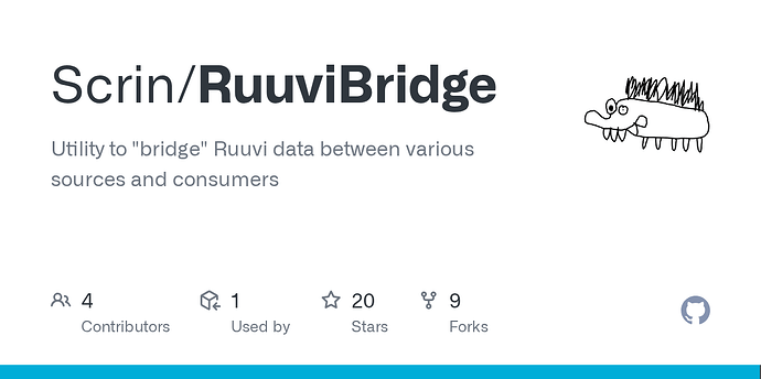

I am about to start taking environmental sensor readings from BLE broadcasts and store them to InfluxDB already setup on my TrueNAS.
Basicly I run Ruuvi Gateway (https://ruuvi.com/gateway/) that does MQTT delivery.
Then I would have this tool
to take those readings via MQTT and store them to the InfluxDB.
BUT: I have absolutely no idea of how to turn that latest release to a custom app on TrueNAS (25.04 / Fangtooth).
Any ideas would be appreciated.
basically create a dataset to store the config file andmap it to the container, take the yaml from the github and install via custom app yaml function ( click the three dots next to the big blue custom app button)

  1. on your apps pool create a Dataset where you want to store the apps config file.
  2. use ssh or the webshell to navigate to that Dataset and create the config with
sudo touch config.yml
and paste in the contend of the example config file. if you already have on paste in your own.
3. go to the apps page and click on discover apps. Next to the blue Custom App button click on the three dots and click on Install via yaml
4. Give the app a name and paste in the compose file from github. Adjust the storage mapping so the config yml will be properly mounted. You may get an error on the first try because of a permission error ( i don’t know the run as context of the app so no idea wich user needs permissions)
This should be all to get the app running
