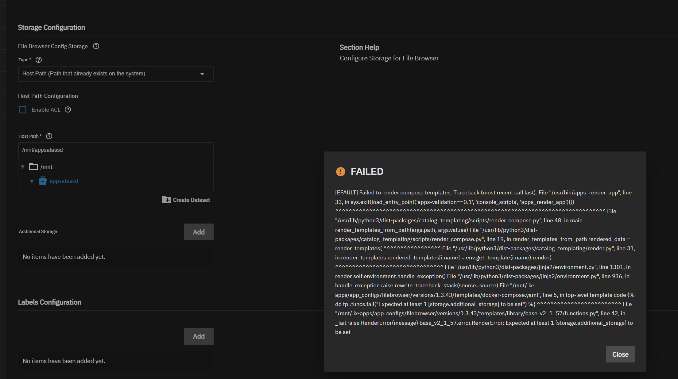

this is a fresh install of Truenas.
I was able to install the Netdata app.

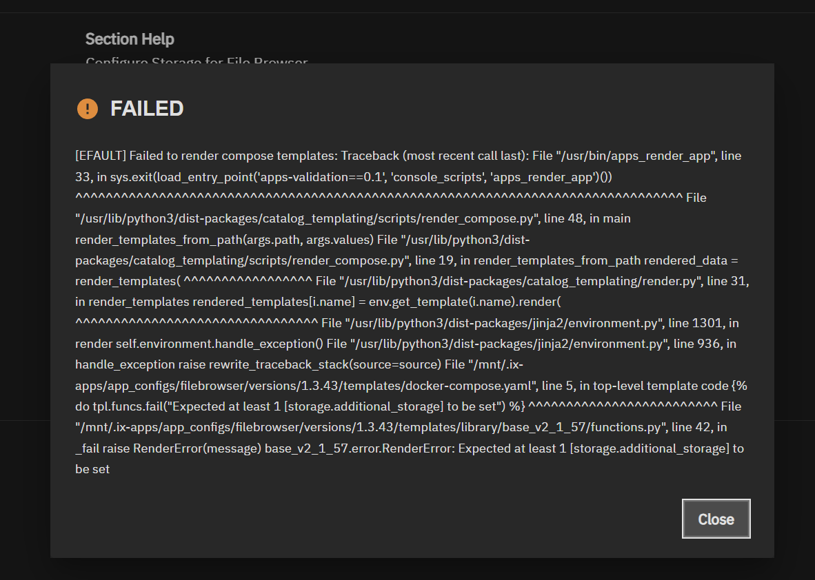

But when I try to install the Filebrowser app, I get an error. Any idea why?
For now I only have a single vdev and a single dataset.

You have to add another storage mount via hostpaths, it’s in the last line of the error you posted

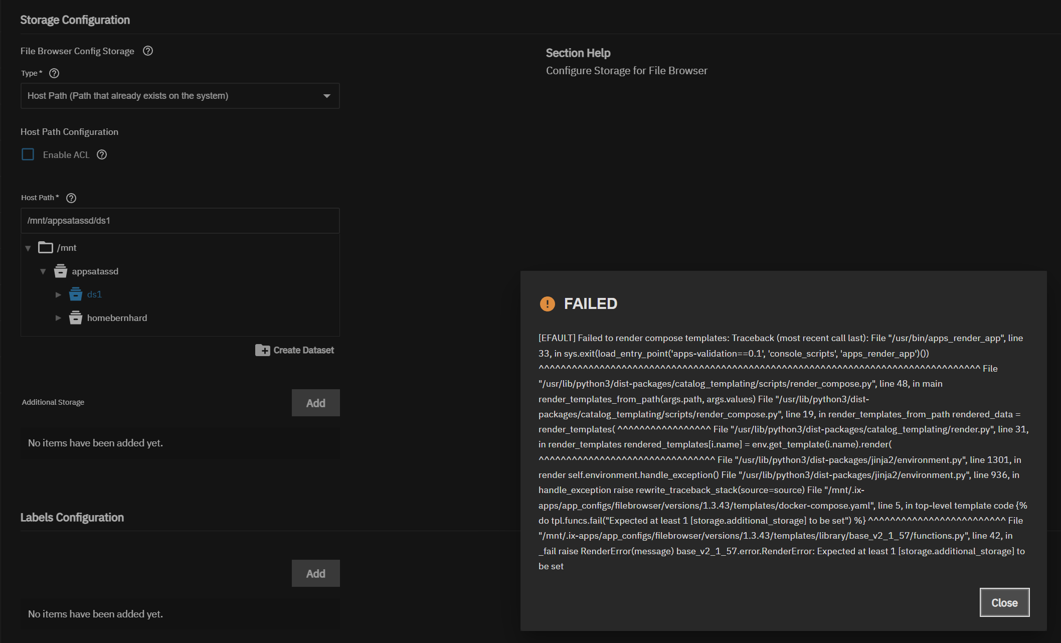

Right now, the error message is unchanged even though I have a host path set (as can be seen in the screenshot)

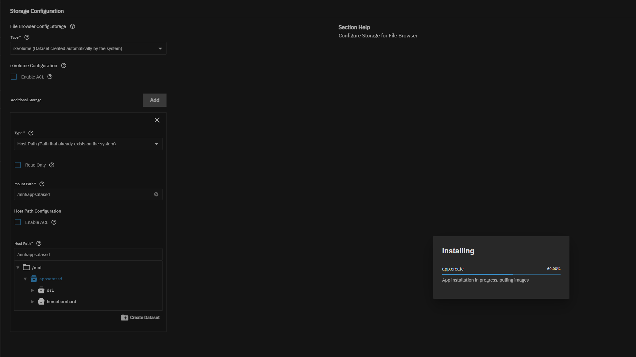

You have nothing set as “Additional Storage” below the “Host Path” definition, but the app expects additional storage (see error message).
thanks.
Works now.

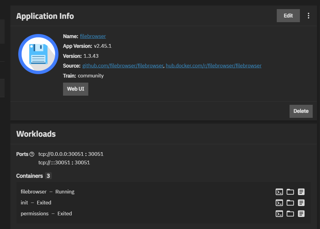

Thought I am not sure if it is working properly.

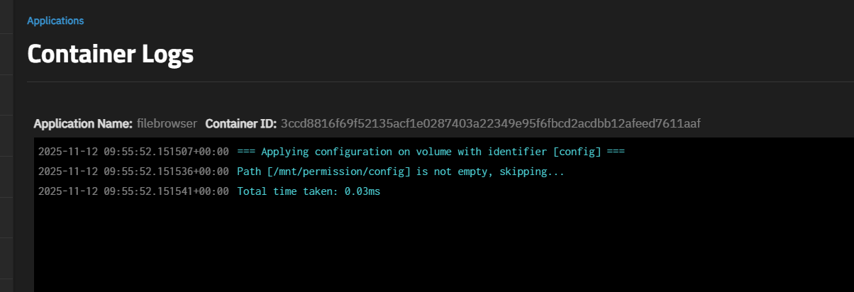

I can see it has three containers. Are all three supposed to be ‘running’ ? Two are exited (but maybe that is normal?) in my case.

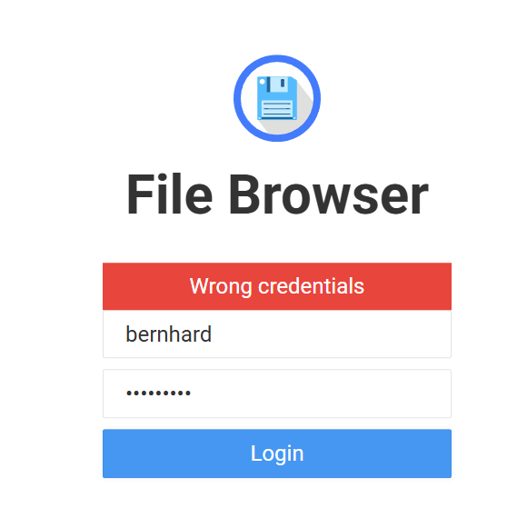

Where can I determine which user can login to the file browser?
I am currently unable to login with my two admin accounts.
That’s correct; File Browser uses its own credentials, as its own docs explain, and has been covered here several times before.
