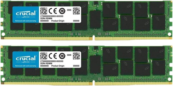

I’m looking for ECC ram.
I know the crucial is slower but at this point does it really matter for the price of $100?
The Crucial RAM you show is Registered (RDIMM), so it won’t work with your CPU. You need UDIMM.

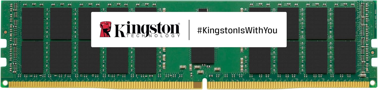

I went with Kingston on my second build because of that. I don’t know if you have a Microcenter near you, but I was able to get one of the sticks at half price because it was open box. Works flawlessly. It would require some luck but if you do happen to have one it could be worth a peak.
One other thing to note is that (again at least with UDIMM) unlike normal Desktop memory its rare to find them sold in kits. Generally you just get however many single sticks you need and they’ll work since they’re only at JDEC speeds anyway. Though the two examples you gave happen to be exceptions.

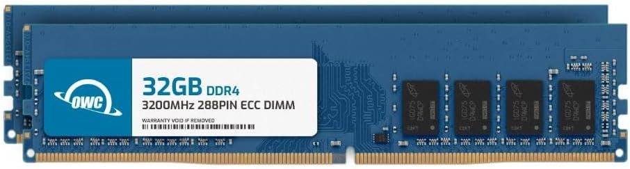

The cheapest name brand UDIMM ECC stick I know of that you can buy without any fuss is this:
The next speed down is basically the same price.
So if you want to save money and don’t want to futz with looking for used sticks/bargins, you could pay nearly half by trying OWC. I think they seemed like the most promissing lesser known brand.

Note that the listing has plenty of options to choose from, including UDIMM, but that the product image is actually RDIMM: chips in “multiples of 9 plus one” in the middle (the “register”.
ECC UDIMM is plainly “multiples of 9”, plus some trace spaghetti in the middle.
Non-ECC UDIMM is “multiples of 8”.

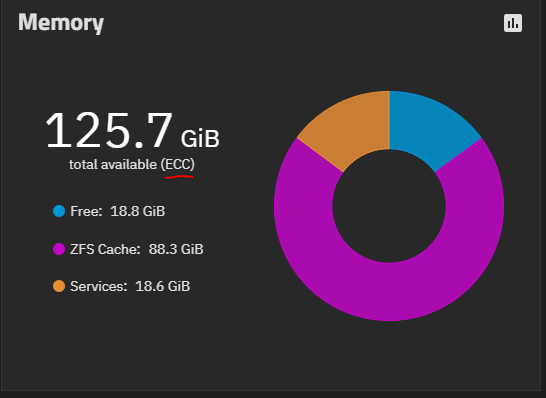

Funny enough Windows has a pretty clear cut error that gets put into the event log when a correctable error is detected, but of course I’m not using Windows on these systems, and doing so briefly wouldn’t be adequate enough as a test.
In rare cases some software can inject ECC errors on purposes for testing purposes, but it seems that many BIOSes lock out this functionality.
For Ryzen specifically, the motherboards that claim support it generally have a seciton under AMD settings for enabling ECC, though it may appear regardless of board for alll I know (will check). Passmark (not that they’re gospel) includes some details about Ryzen under its page for ECC testing that imply they’ve tested at least some hardware from the platform that showed ECC was working properly.
