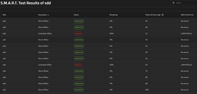

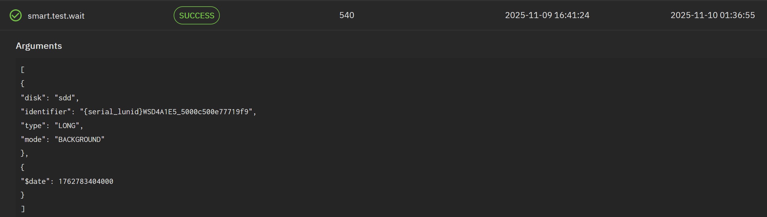

I guess I might be using the wrong terms, or maybe more accurately I dont understand the right terms. It seems I can pass a Long SMART Test as I can see that it succeeded in the Jobs description but the SMART test results of my drive shows the extended offline test failed. Unless they are the same test? But I dont think the time stamps match up?
Extended offline is ‘long’ & based on that screenshot, you aren’t passing :frowning:
ohhh, they are the same. So the success in the Job menu doesn’t actually mean that it passed?

Obviously I can see it has started. But it seems that I wont have anything in the Jobs page to show its running? Or will I get a message when it is finished?
Yes, you won’t.
Negative, you won’t.
It uhh, isn’t a perfect system… man. i can’t wait for IX to improve the SMART GUI!
I guess it means that the job was successfully launched. Which is not the same as eventually reporting that the drive is fine.
Consistently failing a long test means: “RMA or bin”!
You need to come back after that period of time and check the test status smartctl -a /dev/sdd and see if Extended passed or failed.
Since it failed with in the first 10% of the test, it likely failed within an hour or two.
Yup, failed twice now. I tried it once and the just because I was experiencing weird things and it working fine after restart, I tried it again after a restart and it failed again. Good enough for me and going to replace it. I really appreciate all the great info from everyone.
