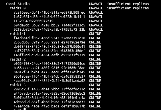

Swapped from an lsi 9208-8e to a lsi 9300-8e (both flashed with IT mode firmwares), and one of my ZPools went down. Turns out the partition ID changed on the drives so truenas doesn’t know where they are. Is there a way I can re-point it or have it re-scan? thank you

This is what i’m looking at for clarification.
Are the disks actually visible to the system? What’s the output of camcontrol devlist (Core) or lsblk (Scale)?
the disks are available in scale showing as not assigned to any pools. i have all the drives information in an excel form (model and serial number)

I’m puzzled as to why the partition-UUID’s would have changed if the HBA’s were in IT mode and nothing funky like a VM with improper pass-through was involved…
Yep! I was able to add my specs to the original post. I can post the output of lsblk when i’m off work for the day.

Output of lsblk
NAME      MAJ:MIN RM   SIZE RO TYPE  MOUNTPOINTS
sda         8:0    0 953.9G  0 disk
├─sda1      8:1    0     2G  0 part
└─sda2      8:2    0 951.9G  0 part
sdb         8:16   0   7.3T  0 disk
├─sdb1      8:17   0     2G  0 part
└─sdb2      8:18   0   7.3T  0 part
sdc         8:32   0   7.3T  0 disk
├─sdc1      8:33   0     2G  0 part
└─sdc2      8:34   0   7.3T  0 part
sdd         8:48   0   7.3T  0 disk
├─sdd1      8:49   0     2G  0 part
└─sdd2      8:50   0   7.3T  0 part
sde         8:64   0   7.3T  0 disk
├─sde1      8:65   0     2G  0 part
└─sde2      8:66   0   7.3T  0 part
sdf         8:80   0   7.3T  0 disk
├─sdf1      8:81   0     2G  0 part
└─sdf2      8:82   0   7.3T  0 part
sdg         8:96   0   7.3T  0 disk
├─sdg1      8:97   0     2G  0 part
└─sdg2      8:98   0   7.3T  0 part
sdh         8:112  0   7.3T  0 disk
├─sdh1      8:113  0     2G  0 part
└─sdh2      8:114  0   7.3T  0 part
sdi         8:128  0   7.3T  0 disk
├─sdi1      8:129  0     2G  0 part
└─sdi2      8:130  0   7.3T  0 part
sdj         8:144  0   7.3T  0 disk
├─sdj1      8:145  0     2G  0 part
└─sdj2      8:146  0   7.3T  0 part
sdk         8:160  0     0B  0 disk
sdl         8:176  0     0B  0 disk
sdm         8:192  0   7.3T  0 disk
├─sdm1      8:193  0     2G  0 part
└─sdm2      8:194  0   7.3T  0 part
sdn         8:208  0   7.3T  0 disk
├─sdn1      8:209  0     2G  0 part
└─sdn2      8:210  0   7.3T  0 part
sdo         8:224  0   7.3T  0 disk
├─sdo1      8:225  0     2G  0 part
└─sdo2      8:226  0   7.3T  0 part
sdp         8:240  0 953.9G  0 disk
├─sdp1      8:241  0     2G  0 part
└─sdp2      8:242  0 951.9G  0 part
sdq        65:0    0   7.3T  0 disk
├─sdq1     65:1    0     2G  0 part
└─sdq2     65:2    0   7.3T  0 part
sdr        65:16   0     0B  0 disk
sds        65:32   0   7.3T  0 disk
├─sds1     65:33   0     2G  0 part
└─sds2     65:34   0   7.3T  0 part
sdt        65:48   0   7.3T  0 disk
├─sdt1     65:49   0     2G  0 part
└─sdt2     65:50   0   7.3T  0 part
sdu        65:64   0   7.3T  0 disk
├─sdu1     65:65   0     2G  0 part
└─sdu2     65:66   0   7.3T  0 part
sdv        65:80   0   7.3T  0 disk
├─sdv1     65:81   0     2G  0 part
└─sdv2     65:82   0   7.3T  0 part
sdw        65:96   0     0B  0 disk
sdx        65:112  0   7.3T  0 disk
├─sdx1     65:113  0     2G  0 part
└─sdx2     65:114  0   7.3T  0 part
sdy        65:128  0   7.3T  0 disk
├─sdy1     65:129  0     2G  0 part
└─sdy2     65:130  0   7.3T  0 part
sdz        65:144  0   7.3T  0 disk
├─sdz1     65:145  0     2G  0 part
└─sdz2     65:146  0   7.3T  0 part
sdaa       65:160  0     0B  0 disk
sdab       65:176  0   5.5T  0 disk
├─sdab1    65:177  0     2G  0 part
└─sdab2    65:178  0   5.5T  0 part
sdac       65:192  0   7.3T  0 disk
├─sdac1    65:193  0     2G  0 part
└─sdac2    65:194  0   7.3T  0 part
sdad       65:208  0   7.3T  0 disk
├─sdad1    65:209  0     2G  0 part
└─sdad2    65:210  0   7.3T  0 part
sdae       65:224  0     0B  0 disk
sdaf       65:240  0   5.5T  0 disk
├─sdaf1    65:241  0     2G  0 part
└─sdaf2    65:242  0   5.5T  0 part
sdag       66:0    0 111.8G  0 disk
├─sdag1    66:1    0     1M  0 part
├─sdag2    66:2    0   512M  0 part
├─sdag3    66:3    0  95.3G  0 part
└─sdag4    66:4    0    16G  0 part
  └─sdag4 253:0    0    16G  0 crypt [SWAP]
sdah       66:16   1  30.5G  0 disk
├─sdah1    66:17   1     2G  0 part
└─sdah2    66:18   1  28.5G  0 part
zd0       230:0    0    40G  0 disk
zd16      230:16   0    64G  0 disk
zd32      230:32   0    64G  0 disk
