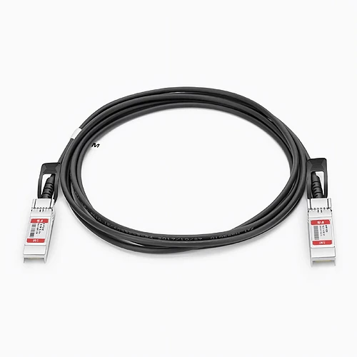

I don’t know what you mean exactly. An SFP+ port carries a transceiver or a DAC cable. A DAC cable is suitable for < 5m. For >5m you need fiber and transceivers. The speed from point to point is configured automatically using the highest available speed on both sides.

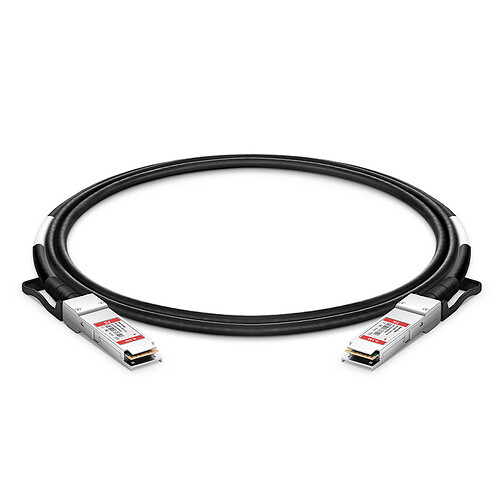

6x Mellanox ConnectX-3 Pro 40Gb Ethernet PCIe CX314A MCX314A-BCCT (two for server + one per client)
4x one meter QSFP+ 40Gb DAC (everything is in the same rack, 20U total height, NAS in the middle, so one meter is enough) ( 40G QSFP+ Cable, QSFP+ to QSFP+ Direct Attach Copper(DAC) Twinax Cables - FS Europe ).
and that’s it?
That should be it, except I’d go for 25G rather than 40G. 40G is a dead end, dead standard, and will throw you into another rabit hole trying to get most out of what is really a bundle of four 10G links with a small number of clients.
Passive DAC’s go up to 7m now it seems from most I see, such as
