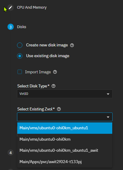

Here’s my issue - I am now following the instructions as indicated here. I have created my dataset /mnt/Main/vms/haos and successfully copied the HAOS to the /dev/zvol/Main/vms/haos. However that dataset is not included as one of my existing Zvols:
I only see it when I “Create new disk image”.
Are the instructions noted wrong for 25.10.2.1 - Goldeye because I don’t see the behavior indicated there.
