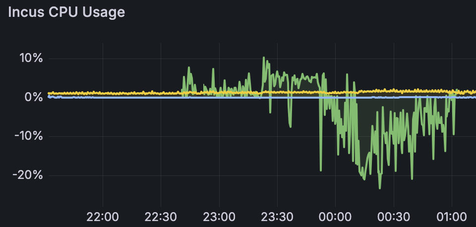

The CPU time seems to also be reported as negative on some cores:
incus_cpu_seconds_total{cpu="4",mode="user",name="debian-test",project="default",type="virtual-machine"} -0.14
The MemAvailable metric does not change depending on how much memory is actually used by the VM. The cpu_seconds_total does however change over time. I am not sure why though. I tried to test if CPU usage impacts it but loading a benchmark on the VM does not change the graph significantly. Which is also weird since normally it should go up to close to 100%. Node exporter for example shows that the host CPU gets a utilization close to 100% but the incus graph stays relatively flat.

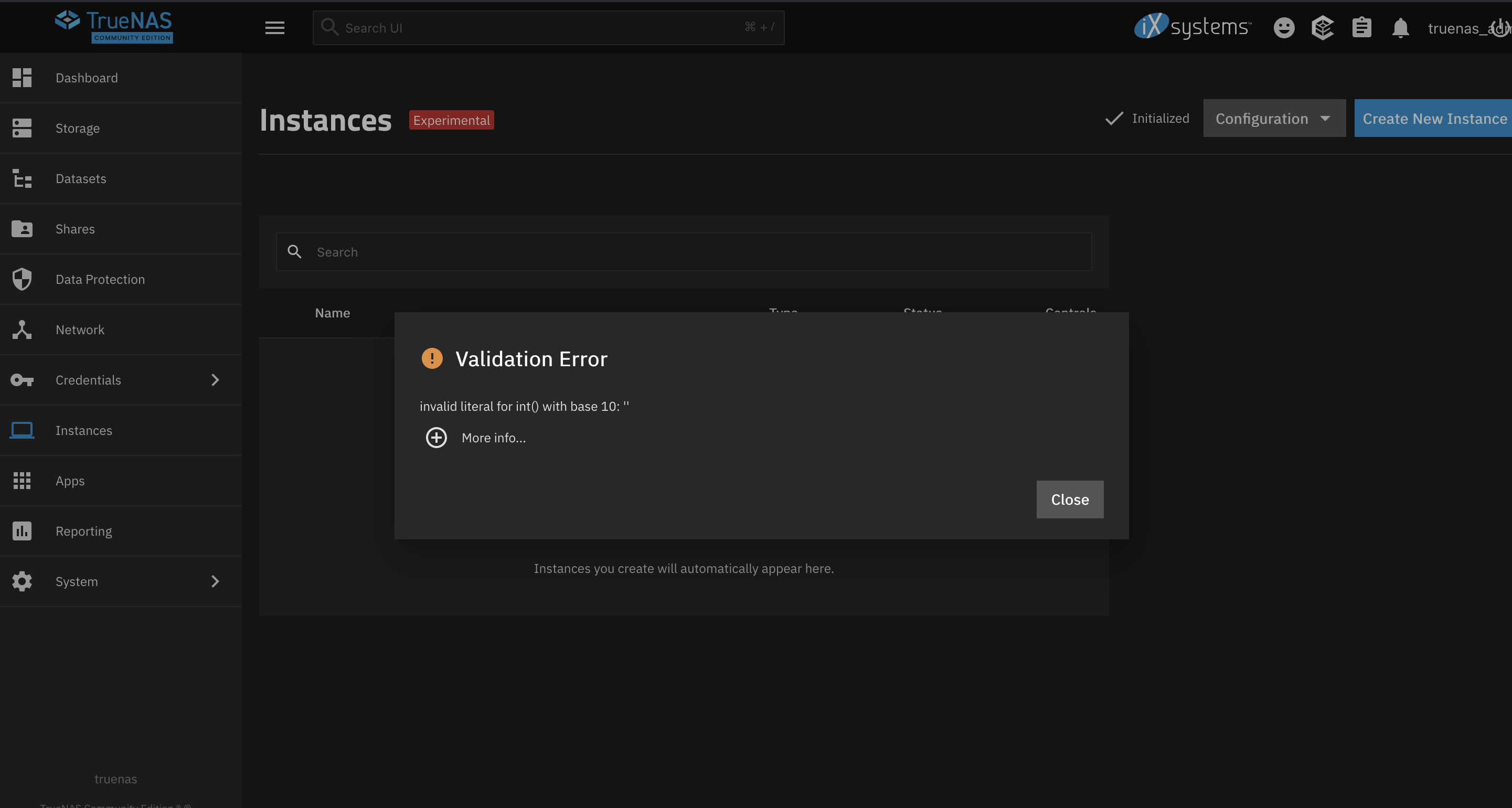

Then I though that maybe the TrueNAS WebUI might show the correct data but when I try to go into the “Instances” section I get this error:
I am not sure if this is related to the metrics issue. I found this bug report but the error message is slightly different and it also doesn’t seem to be a race condition like the report described since it always happens when I try to access it after starting the debian VM.
This whole bug can lead to some weird graphs like these:
(Green is the debian VM) Query: sum by(name) (irate(incus_cpu_seconds_total{mode!="idle"}[$__rate_interval])) this then gets divided by the number of cores and multiplied by 100.

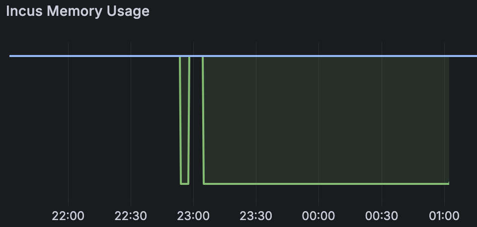

This is the memory:
(Green is the debian VM) Query: (incus_memory_MemTotal_bytes - incus_memory_MemFree_bytes - incus_memory_Cached_bytes)

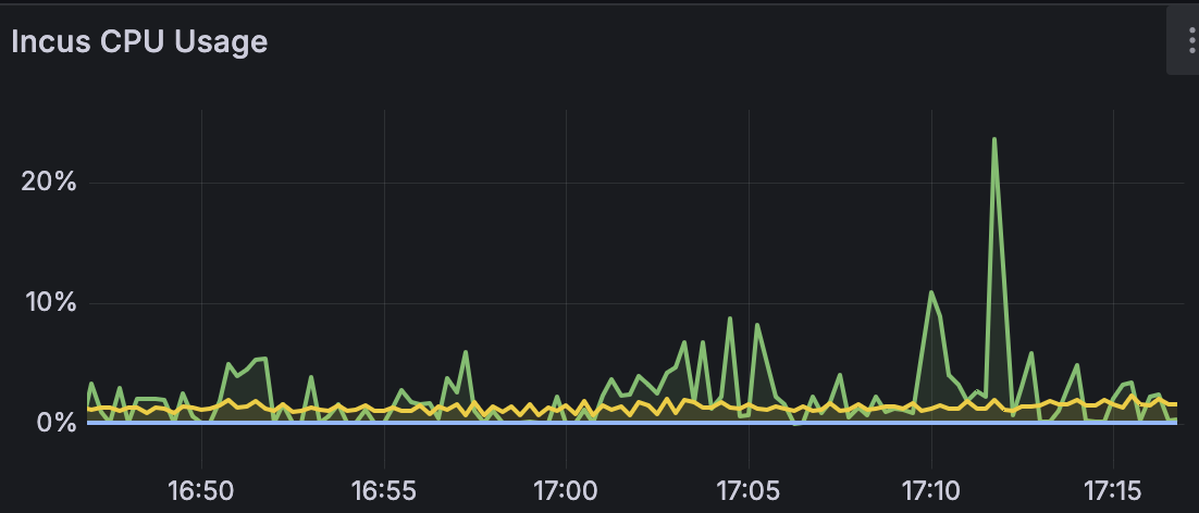

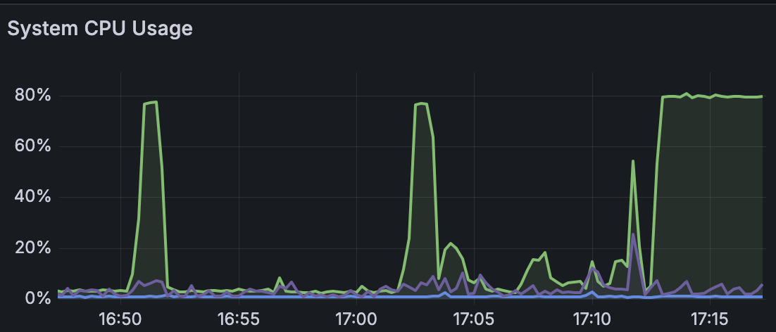

These are the graphs when I run a benchmark inside the VM:
In this case the API returns this: (Only copied it for one Core, the others are basically the same)
incus_cpu_seconds_total{cpu="5",mode="iowait",name="debian-test",project="default",type="virtual-machine"} 0
incus_cpu_seconds_total{cpu="5",mode="irq",name="debian-test",project="default",type="virtual-machine"} 0
incus_cpu_seconds_total{cpu="5",mode="idle",name="debian-test",project="default",type="virtual-machine"} 0
incus_cpu_seconds_total{cpu="5",mode="nice",name="debian-test",project="default",type="virtual-machine"} 0
incus_cpu_seconds_total{cpu="5",mode="softirq",name="debian-test",project="default",type="virtual-machine"} 0
incus_cpu_seconds_total{cpu="5",mode="steal",name="debian-test",project="default",type="virtual-machine"} 0
incus_cpu_seconds_total{cpu="5",mode="system",name="debian-test",project="default",type="virtual-machine"} 19.77
incus_cpu_seconds_total{cpu="5",mode="user",name="debian-test",project="default",type="virtual-machine"} 2.79
Which honestly looks fine to me but I’m by no means an expert, maybe for the CPU part I misconfiguration something in the dashboard.

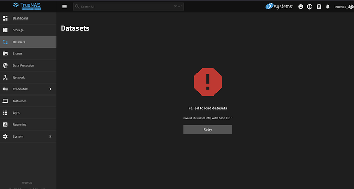

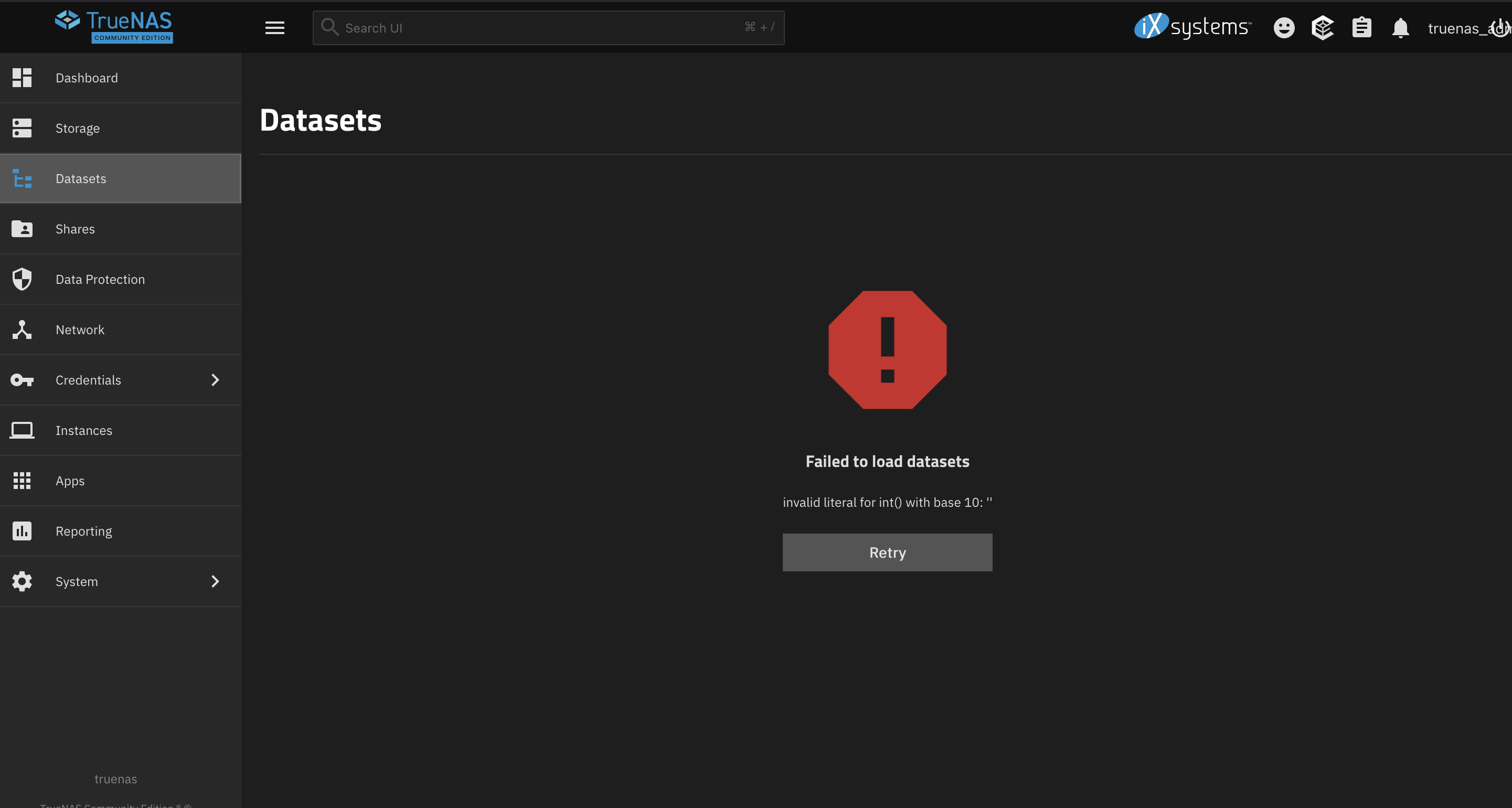

For some reason I also get an error when going into the dataset tab while having the VM running.
