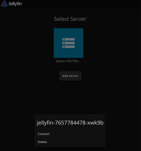

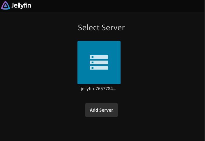

Back to the not finding the server, so what I found is that the Jellyfin app create a site data store in your browser. If you run into the that error, here are two thing that worked for me:
  • Go into the Browser Settings, find Cookies and Site Data. Look for the IP address of your TrueNAS or Jellyfin server. Remove it.
  • If the error pops up, open in another browser, find out what the new Jellyfin server is called… “jellyfin-nnnnnnnnn-xxxxx”. Return to this misbehaving browser, delete the existing server and enter the IP of the Jellyfin server, and it should find your Jellyfin server. Select it and you are good to go.
