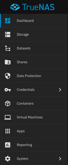

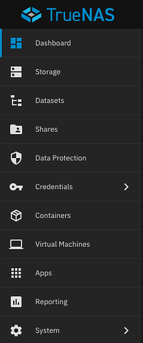

I think they’re “containers” now:
(this is 25.10-RC1; it’s the same in the latest 25.04 release)
Thanks for the screenshot @dan, so Containers will be there yet? As far as I understood the plan was to remove incus, the Containers GUI will allow to manage the LXC layer?
