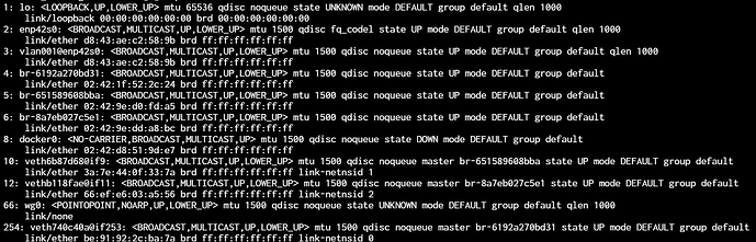

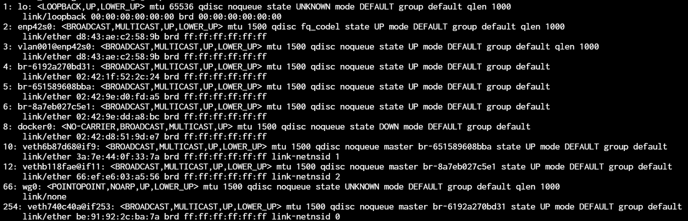

ip link to tide you over while I figure out why ifconfig is giving me issues.
Context on VLAN: I needed to separate my apps via some static IPs because my reverse proxy needed more direct IPs to bind domains to so I set one, single VLAN up, configured some IPs, assigned to apps, everything working (hooray!)…except on Fangtooth (ugh)
Well it at least tells me that enp42s0 is likely what is going to be critical & it is at the very least up - so thats good!

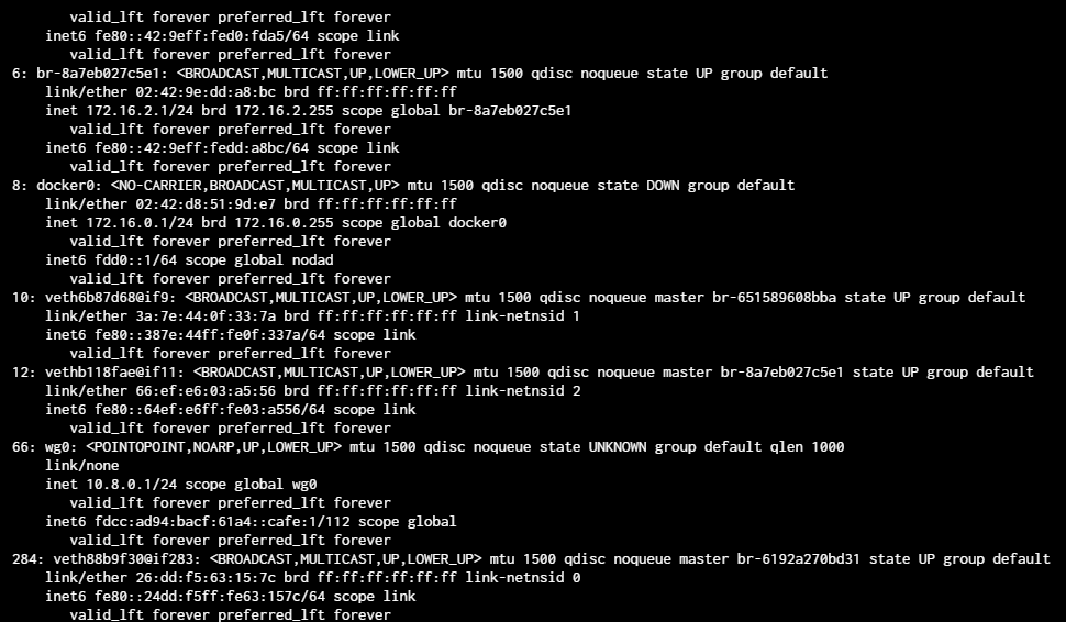

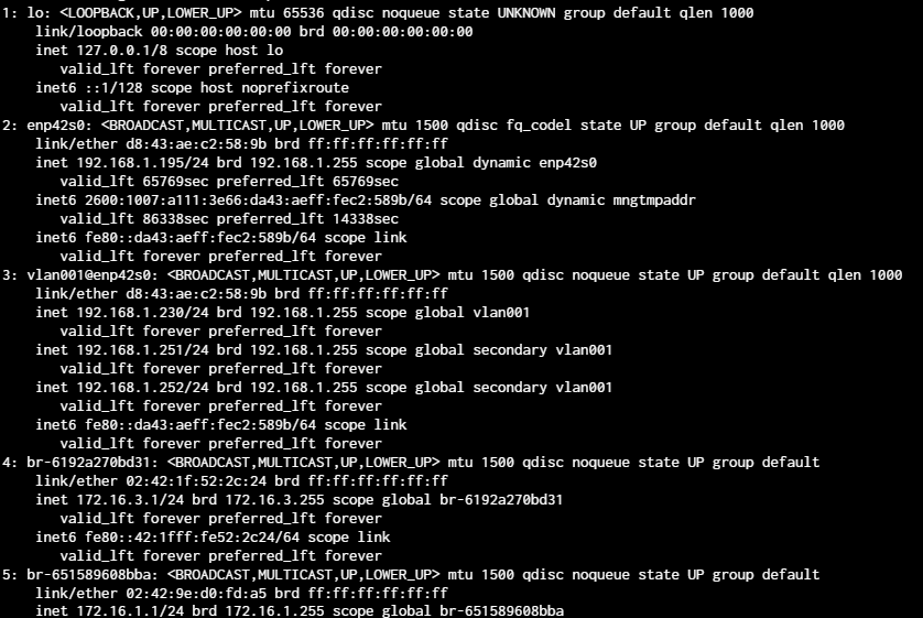

Ah, I forgot my Linuxisms. ifconfig == ip a
Also yes, enp42s0 is my direct ethernet port-to-router. I’d be surprised if it was not up.
Am I crazy, but shouldn’t you VLANs & docker be on a different subnet & this can otherwise cause issues (ie; the way you have it setup is not recommended)?
Also can your NAS ping back to 192.168.1.1? I’m just curious if your router sees it at all on IPv4, or if IPv6 is carrying this whole thing.
Uhh what else. wg0 is in ‘unknown’ state, I have no clue what that is, but maybe it is bad?
If I had to fix this & this NAS was just dump’d onto my network with the instructions of ‘make it work’, I’d likely delete everything other than enp42s0, then add it back step by step, checking that nothing is failing along the way, step by step.
I could be way wrong, but if you’re going to be using VLANs, is there even a reason to have an IP assigned to enp42s0? Wouldn’t this be a situation like a bridge where the VLAN should have the IP, not the physical port itself? It is embarrassing that I deal with networks professionally and don’t actually know this off the top of my head - but then again I’m not responsible for the Core routing…
