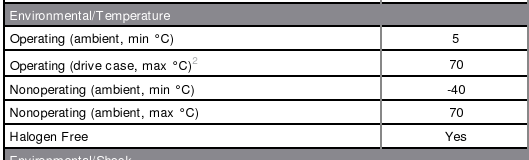

Do HDDs have a shelf life? Assuming it doesn’t get damaged due to shock or moisture, is there anything I would practically need to worry about in keeping a disk in (potentially very) long term storage?
That is a good question. The only thing I might be concerned about is if the drive was Helium filled, the helium “could” leak out over time. I’m not saying it will, but could.
To be honest I have not giving this plan much thought. If it were me and I had to keep the system operational all the time, meaning that it “must” be online, no powering the unit off for a few days, then I’d periodically run a SMART Extended/Long test on the drive, probably once every 3 to 4 months just to make sure the drive appears to be operating good. I would also place it in some external drive case so I wouldn’t need to make any changes to my NAS. The external case could be USB, but sometimes these can be tricky to get smartctl to use the correct interface type. If used in a Windows system just to run the SMART test, that is easily done as well.

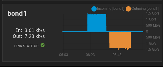

I tried to balance between tolerance for disk failure, performance for a range of tasks (VMs, SMB, streaming/transcoding), and ease of administration offered by mirrors.
If I may challenge the suggestion a bit- could you expand on some of the tradeoffs with a single RAIDZ2 vdev? As long as I can still saturate a 2.5GbE link I think I could be happy, but I am more concerned about the administration side of things and ease of future expansion.

I don’t see why you couldn’t saturate a 10GbE connection. You need to have a decent system of course.

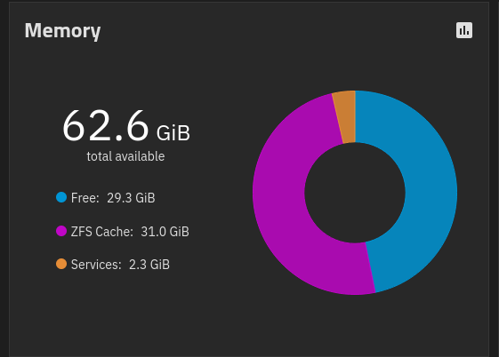

I picked up a UGREEN DXP4800 Plus and swapped out the boot disk. I also upgraded the RAM to 64GB, luckily right before the prices shot up, and I picked up a data center NVMe disk which I partitioned to 16GB for use as a SLOG. I have UPS backup and the SLOG disk has PLP capacitors, so I felt OK to not mirror that.

If you have 64GB RAM, then odds are very good you would not need an SLOG. You could always remove it and then test the speed of your system. Do you even notice a difference? And if you notice a difference with the VMs, then I would recommend you use two NVMe drives in a Mirror for your VMs. That would make things much faster for a VM. Of course I don’t know how much memory you are allocating to your VMs so that matters as well. It all comes down to experimenting with what you have.

Device State:                        Active (0)
Current Temperature:                    40 Celsius
Power Cycle Min/Max Temperature:     39/42 Celsius
Lifetime    Min/Max Temperature:     25/52 Celsius
Specified Max Operating Temperature:    70 Celsius
Under/Over Temperature Limit Count:   0/45
SMART Status:                        0xc24f (PASSED)
Vendor specific:
00 00 00 00 00 00 00 00 00 00 00 00 00 00 00 00
00 00 00 00 03 00 00 00 00 00 00 00 00 00 00 00
SCT Temperature History Version:     2
Temperature Sampling Period:         5 minutes
Temperature Logging Interval:        59 minutes
Min/Max recommended Temperature:     10/25 Celsius
Min/Max Temperature Limit:            5/70 Celsius
Temperature History Size (Index):    128 (16)

Regarding the SLOG:
I we put performance aside, would I maintain write safety for synchronous writes (i.e. for iSCSI) without one?
Sorry, I should have been clearer, I only needed the info from one of the drives since they are all the same model.
I am actually a little surprised there is no mention of helium at all, the only remote indication is the Pressure value, and that doesn’t say helium. I had to go look up the spec for this drive to know it was helium filled.
What did I find out?
  1. This: Min/Max recommended Temperature: 10/25 Celsius and guess what, you are definitely above this. The Max temp is 70C so you are still technically good, however if the recommended max temp is 25C, then it was designed to be in a cold room. Again, not really an issue but just wanted you to know. It is important to look up the specification of whatever you are purchasing.
  2. You have only run one SMART Extended/Long test, and no other SMART tests. I recommend you setup to run a Daily SMART Short test on all drives and a weekly SMART Long test on all drives. the easy way is to use something like Drive_Selftest or Multi-Report (which contains Drive_Selftest) which will by default perform this. The Long tests would be split one drive a day, a week. Again, by default this means on Monday you would have 3 drives running a short test and one drive running a long test. This will cycle the long tests to all the drives each day. Once all drives have been SMART Long tested, no more drives will have a Long test that week.
You saw me use the words (by default), this means if you make no changes to the settings, that is what the script will do. If you are only using Drive_Selftest, then you only need to run the script from CRON. If you use Multi-Report, then there are a few small things to setup, but it is fairly easy. Just realize you should use the default values until you are certain the script is working and then only change a setting if you feel it should be changed. In Multi-Report there a a gazillion optional settings.
I hope this helps you some. Well it is bedtime for this old man. If you have any questions about the scripts I mentioned, you can leave a message on the Multi-Report thread, if I don’t answer it, someone else will. I only suggest this so you are not waiting around all day waiting on me. I’m trying to purchase a new car and the prices are nuts. $65,000 USD out the door. That is more than my first new built house. That should tell you how old I am. There I was with Chris, I always called Chris Columbus by his first name. We drank Grog to pass the time, and throw people overboard that got ill. We didn’t have penicillin back then, it was Grog or die.
And that’s at idle. :frowning:
I’m surprised at the cold room requirement, too. Those are consumer IronWolf (non-pro) NAS drives and even came in a bundle with my unit from the retailer. Maybe I should get a WD Red and swap one out, for some variability.
My equipment room is very small and not well ventilated. This time of year our furnace is running and it’s not right-sized for the house unfortunately. It cycles a lot and makes us sweat when it kicks on, even if we set the thermostat low.
I see the Multi-Report link in your signature. Will definitely take a look at that.
Best of luck with the car. You’re still driving so there’s clearly gas left in the tank :wink: Have a lot of fun! Enjoy the downtime and thank you again.
My advice on the drive temperature thing, 25C is a rather low temperature for a hard drive and I can say that this is the lowest temperature for a Max temp on a drive I’ve ever noticed. There are probably other drives out there in a similar situation, as I said, I just haven’t noticed it. You have a 70C max temp on the drive, which is close to the max temp on many drives and you are running at least 20C below that limit. You should do some research on that drive model, maybe there is more data to gain about this temperature Min/Max. It just seems very low to me.
The Seagate website states this for your drive model, so you are safe, I would have imagined that Non-operating would have been higher that 70C, but I’m not Seagate:
I did not intend to scare you about your drives. Keep using them, investigate if. Many people use these drives, this is as I said, the first time I’ve noticed an Operating Min/Max temp like this.
If you use Multi-Report, you can set the alarm thresholds and I would set it to 55C to start with. The default values will likely give you an alarm indication in the email. The goal with the email is to have an “All is Good” subject line under normal conditions, this includes a SCRUB where the drives do generate more heat. Then adjust the upper threshold to a few C above that value. This will let you know if something may be wrong, then you can investigate it. If you use this script, Never let it keep sending you an email with an alarm condition. If it has one bad sector, there are “Compensation” values to address this and to make the script accept the value as a non-alarm condition. If you keep seeing alarm emails and you think it was due to something small, would you realise if an alarm was then serious? Hopefully you understood what I was saying. I can be long winded at times.
Best of luck to you, I’m sure everything will be fine using those drives.

Hello again,
I redid the pool as 4-wide RAIDZ2, but I’m surprised by the numbers I’m seeing in initial testing. I don’t think it’s the pool layout. I wonder if something else is amiss (or I just have to reset my expectations?).
Using a 32GB test file with random bytes, I transferred it to an SMB share and then also back again. In the client→NAS transfer (blue plot) I got a sustained ~161 MB/s. In NAS→client direction (yellow plot) I got a little less at ~154 MB/s.
The reason I tried with a 32GB file is because I assumed it would fit entirely in ARC since my system has 64GB and it’s almost all free at the moment. That is in fact what I saw, because at the end of the initial transfer the ARC had grown to almost that size:
I expected the NAS→client transfer to be much faster, since in theory it would be reading from RAM. I think it was, because I could not hear the disks being accessed during this transfer.
I’m adding additional network info / stats below in case relevant. The client PC and the SMB service (via bind IP) are on the same VLAN with ID 30 (172.21.30.0/24).
Appreciate any insights the community can offer.

The NAS main IP with the default gateway is 192.168.1.118, but the SMB service has a bind on 172.21.30.118 in Services settings.
It looks like the issue might just be SMB protocol overhead. I did the same test over NFS and I got the full 2.5GbE line rate on upload to the NAS :slight_smile: Haven’t been able to test download yet (permissions issue) but I expect similar results.
