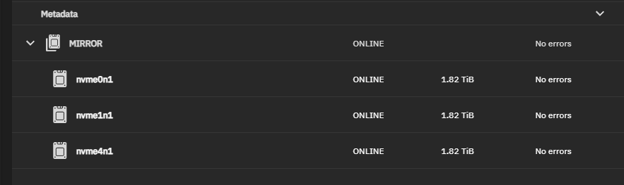

Thought all was well, as the devices display showed:
But while checking on something else, I found this under lsblk:
nvme1n1     259:0    0   1.8T  0 disk
└─nvme1n1p1 259:3    0 929.5G  0 part
nvme4n1     259:1    0   1.8T  0 disk
└─nvme4n1p1 259:4    0 929.5G  0 part
nvme0n1     259:2    0   1.8T  0 disk
└─nvme0n1p1 259:5    0 929.5G  0 part
So it really didn’t expand the size, just told fibs about how much it was using to make me feel good.
How do I get this vdev to expand out to fully use the ssds.

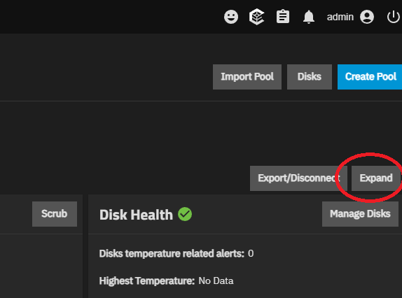

I initially tried this button:
Which led to this post. But YMMV.
But after much searching and crossing my fingers, I did this for each of the devices in turn:
zpool offline  <pool> <device>
parted /dev/<disk> resizepart <partition> 100%
zpool online -e <pool> <device>
So far I haven’t seen any issues. But I also haven’t done a full scrub since the changes.
Cheers.
Hey! Thanks for the help. Very stupid for me to not see it. Doing the expand from the GUI fixed the size:
